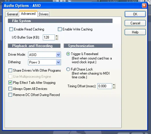

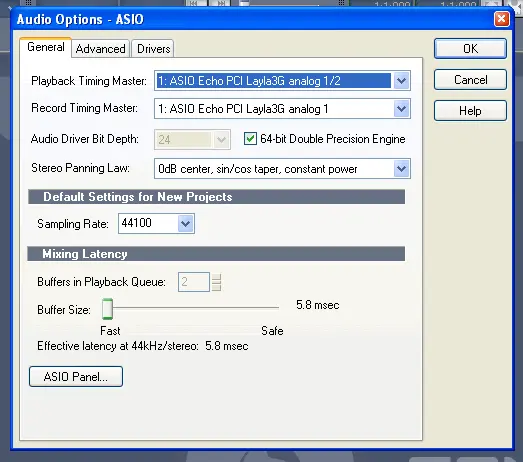

No need to lock the sample rate if you're using Sonar. I use Sonar 5, and my Layla runs flawlessly. I have the Syncronize Wave Devices checkbox checked too (think it was by default).
I attached some screen caps of my audio settings in Sonar 5. My buffer setting is at about 256 samples in the Layla control panel, but I can knock it down a notch and have been OK at 128 samples (I'm just more conservative I guess).
