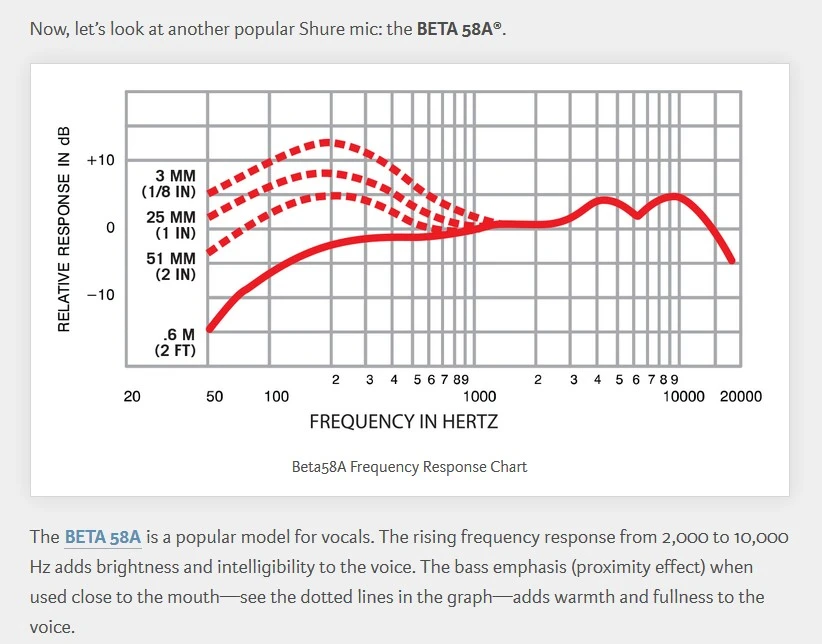

Two completely different ways to capture sound. Dynamic works better for live broadcast, handheld, singing live, and other venues where absolutely realistic accuracy is less important, and eliminating background noise is more important. Dynamic mics work like a speaker in reverse, and require no additional power. Condenser mics require 48V to generate their signal. You can get a top of the line dynamic mic for under $500. Top of the line condenser mics cost more, are more delicate, and require a bit of distance from the mouth.
'Proximity effect' that I mentioned in one of your other threads. Both condenser and dynamic are capable of it in different degrees so long as you are using a cardioid type of pattern. 'Intimate', the word you used is what you want to do with the mic.... get up close. Getting up close also means you can reduce the gain of your preamp, which means less room sounds are picked up.
Here's a frequency graph of a popular handheld dynamic mic. Note how the bass sensitivity changes with distance to the mic....proximity effect. Condensers will be similar. Find the 'sweet spot' distance that gives a good balance of the sound you want.

The other thing to note is that this effect is more apparent, and changes in the mic response more noticeable, the closer you get. So, if you're 3" away and move to 6" it's a bigger, more audible, difference than if you're 12" away and move to 15" say. But, as [MENTION=190964]arcaxis[/MENTION] points out, when you move back you'll probably increase the gain, which means that more of the room sounds are captured.
The Electro-Voice RE-20 is a dynamic mic designed to have less proximity effect. This makes it popular for some folks perhaps because they don't stay a uniform distance from the mic, and so allows a bit closer work without as noticeable changes when moving around as the SM7b would show at the same distances. (NB. I tested the cheaper RE-320, which looks like the same design, but I found its proximity effect to be pretty noticeable.)

The Proximity Effect is present for any directional mic to some extent (if you want the technical dope it is because a distant sound has a spherical wavefront but a very close one tends to planar and directional mics are sensitive to the change)
