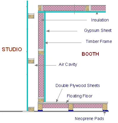

What you need for isolation is something airtight, with a lot of mass. It should be mass-air(cushion)-mass, where in the inner mass is decoupled from the outer, as shown. Then you gotta treat the inside will absorption etc. I doubt you'll get a good sound in such a small room, so you will want it quite dead at all frequencies, so no boominess. Then you can add the reverb you want later.
I'm not sure what you want. A sceen won't give any isolation, and will probably make things sound worse.
