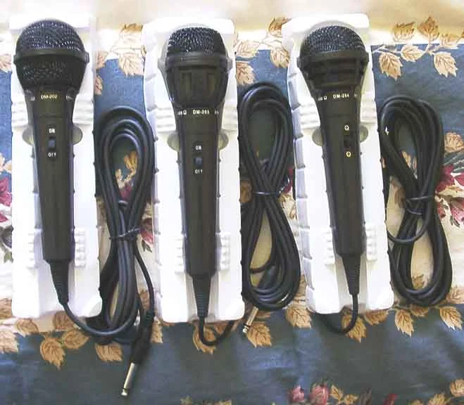

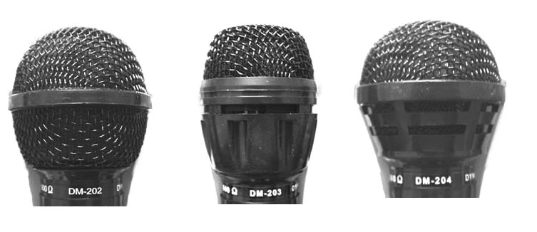

they come with three different capsule housings

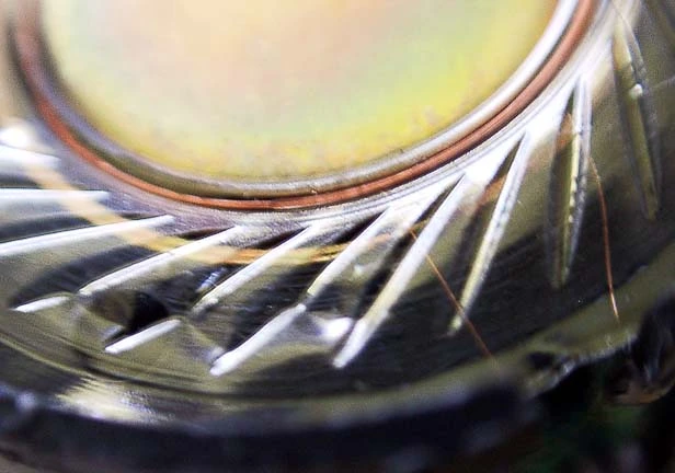

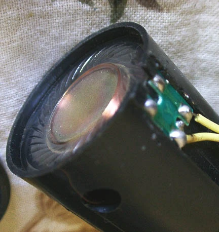

here's the capsule/diaphragm

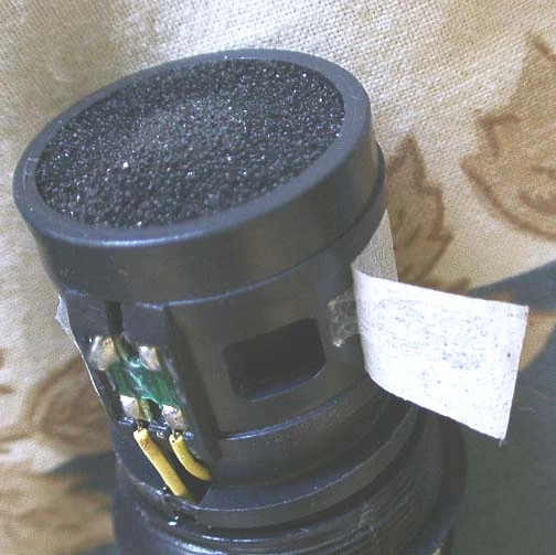

another model has foam over the membrane
hmm, what's that tape doing there?
oh, maybe second thoughts
and a retrofit
to improve the sonic characteristics
Looks like it's covering the ports behind the capsule. That would turn it omni, IIR, and if it's cardiod to begin with.
Anyone recognise the one in the middle
Hi,
I see a Shure and an AKG. Anyone recognise the one in the middle?
Thanks,
Hairy Larry
They look simular to the Ones I get for a Dollar up here in Canada accept the Ones I get have a detachable XLR Cable......
Those Plastic (Mylar??) Diaphrams are the Same as the Ones In my Dollar Mics and they suck pretty bad....
I don"t use the Dollar Mics I get , well not for anything really musical , what I do is I gut the Bodies and Build my own Condenser Mics out of the Cheapo Mic bodies as that is all they are really good for....
