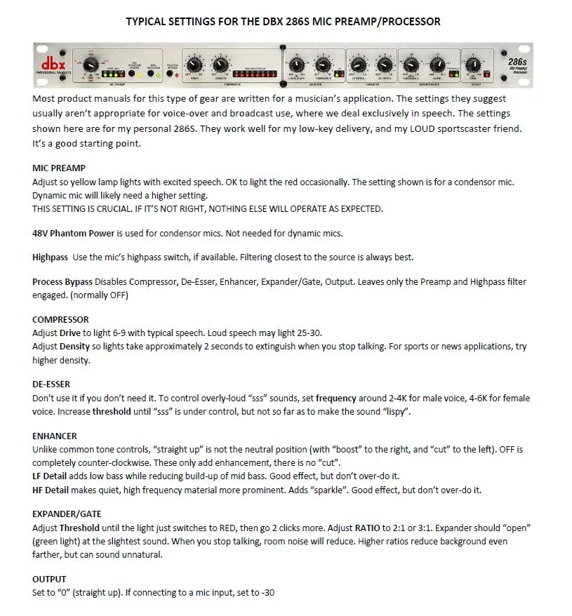

For the dbx 286s this guide recommended setting output gain to -30db (all the way down ) if connecting to a mic input.
http://www.bswusa.com/BSWUSAImages/Product_Collaterals/286s_new_look.JPG
Since the output is going into my uac2 mic input should I follow it's advise as you guys have mentioned the output should be at 0?
Thanks
Well, a MIC input isn't a combo jack and often there is additional gain structure. So take their advice and see if you need to adjust it upwards

yeah I also found another article which explains the reason why the gain offset is reduced.
dbx 286s: Beyond The Basics … – produceNewMedia
Output Gain Compensation
Gain Compensation is an integral part of Audio Compression. It is most commonly used to offset the gain reduction that occurs when audio is compressed. It is often referred to as Make-up Gain. When this gain offset is applied to compressed audio, the perceived, average level of the audio is increased. Excessive Make-up Gain can sometimes elevate noise that may have been previously inaudible at lower average levels.
Earlier I discussed how an elevated Drive control setting on the 286s will increase the input signal of low level source audio. In doing so you may pick up a suitable amount of compression. However you also run the risk of a noticeable increase in noise. In this particular scenario, try setting the Output Gain on the 286s to a negative value to offset the gain (and noise) that may have been introduced by the Drive setting.
