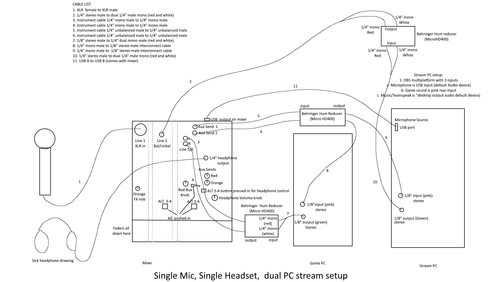

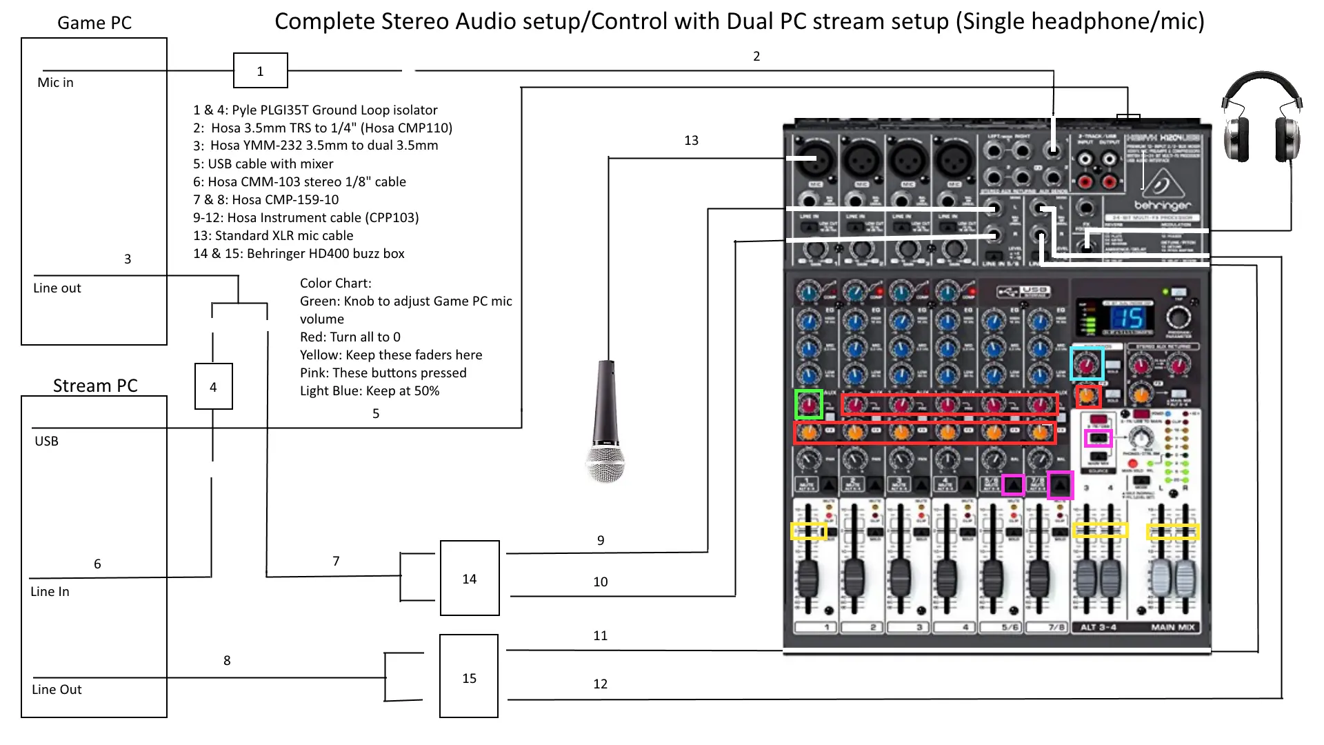

I've been searching through his Youtube channel and he has an updated setup diagram
YouTube
It seems the functionality he has which I am looking for is the ALT3+4 Mix Bus.
Because he plays music on the streaming PC, if he wants he can turn down the streaming PC volume on the Mixer which will still allow the stream to hear the gaming audio. This allows him to control audio he hears from his gaming PC independantly in his headphones from the streaming PC.

Got an email back from the supplier who were extremely helpful.
Hi There
Apologies for the late reply. If I’m reading your message and understanding what you’re trying to achieve correctly, then I’m fairly certain that the Zed-10FX is not the right unit for the job. You would need a mixer with an additional set of outputs to be able to setup the feeds correctly from what I can see.
An Allen and Heath with the additional bus outputs is a lot more expensive I’m afraid and would also be an overkill for this purpose as it would have far more inout channels than you need.
The Behringer X1204 from the video is a good bet for a small, low cost unit but we’re not a Behringer dealer so we wouldn’t be able to assist with that.
The Yamaha MG12XU, Soundcraft Signature 12 or behringer ufx1204 have the sub group you require and the sweepable mids feature is on the Soundcraft & Behringer
