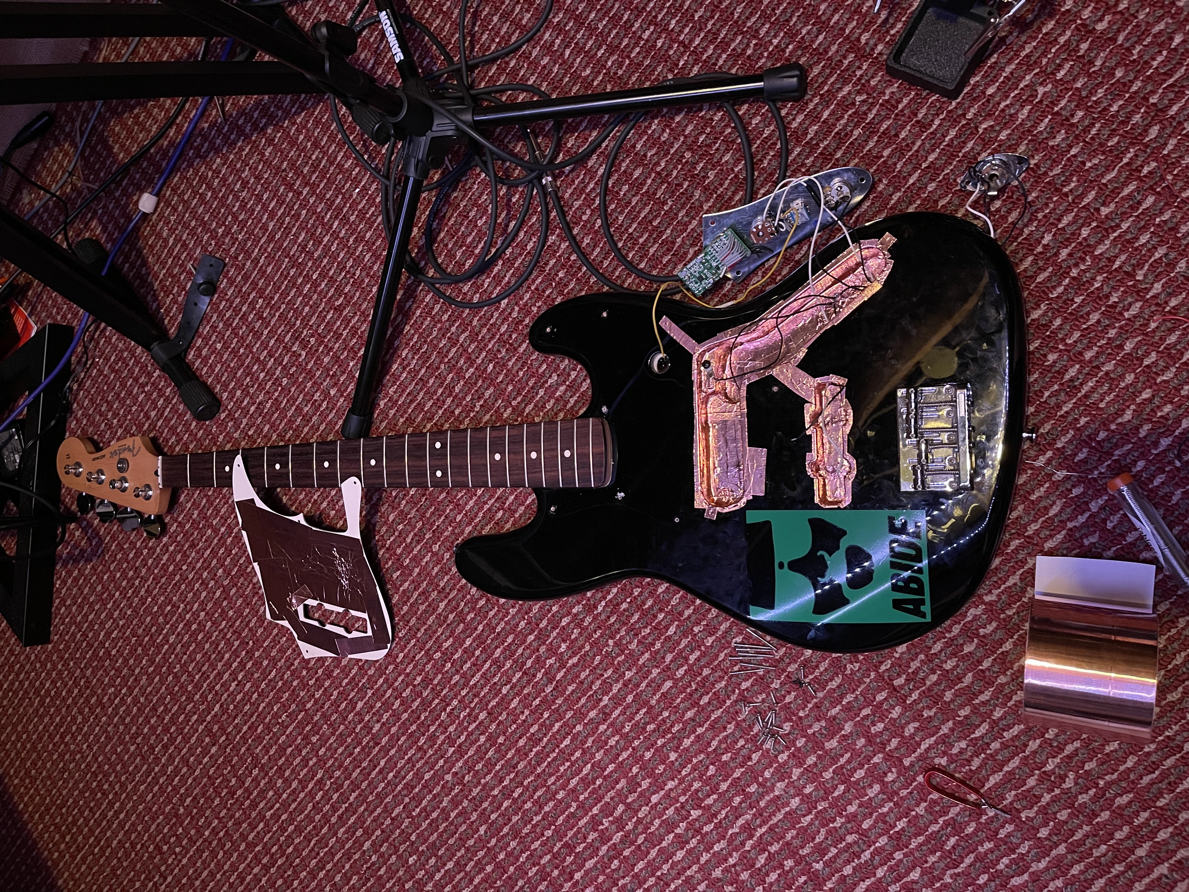

The mwjb aren’t easy to get in the US, so I ordered some split coils from fralin. Also got some copper tape and shielded the inside of the bass while I was waiting for the order to fill. The pickups just shipped, so I should be able to get them installed by the weekend.

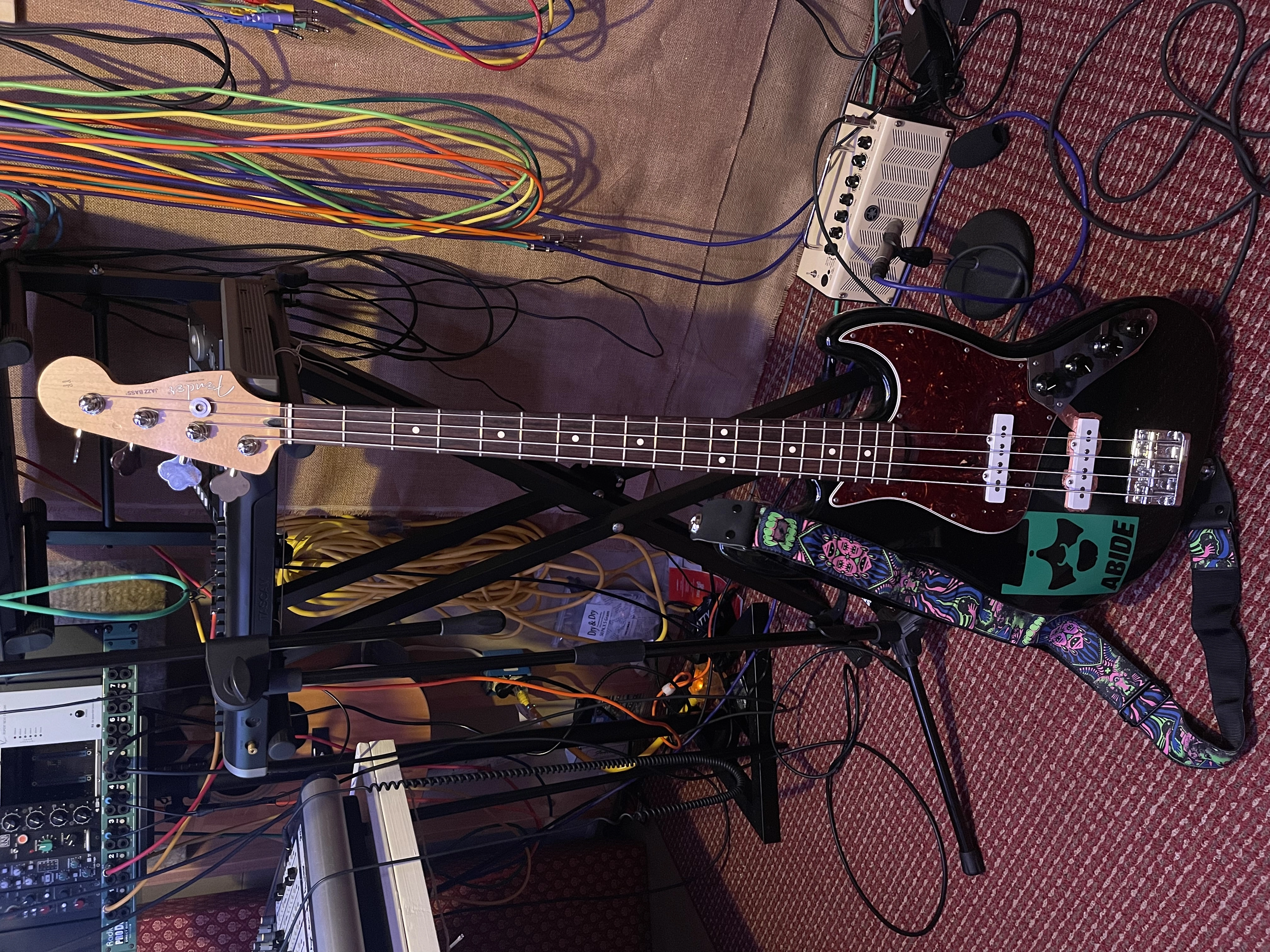

I got the pickups installed and the difference isn't night and day, but it is a lot better. With the stock "noiseless", I had buzzing coming up whenever I wasn't playing, even when holding the strings. But with the Fralins, it's pretty quiet as long as you're touching a string. The remaining noise is probably coming from the controls, which I kind of butchered a while back. When I feel like spending more time on it I'll see if there's something I can do there.
