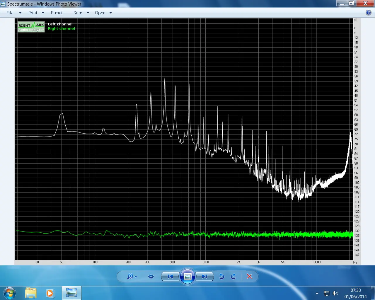

Some "pie" for me today! You r are correct that there are no significant harmonics from a guitar pickup past about 6.5kHz (tho' we could dicker as to what "significant" and "passed" mean!)
My spectrum shows the last obvious spike at 8kHz and that is about 54dB down on the mid-band level, I took a line through 520Hz. How'ed I do dis?
Chinese Tele into an 8i6 into PC running Samplitude SE8 24 bits, 44.1kHz and I strummed the top 3 strings at the octave. I dare say if I had gone further up the fretboard and hit it harder I could have produced rather more HF but you are essentially right. Pups, at least Chines Telecaster ones, do not deliver much past 8kHz. The rising noise I am a bit concerned about, firt time I have "specc'ed" the 8i6 and WTF the artefact at 19kHz is I have no idea!
