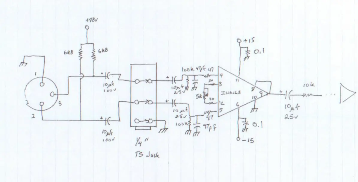

Well this is the first installment in the DMP3 mods project. As you may recall Antichef gave away his DMP3 and I was the one to win it (Super thanks again!). I wanted one to take apart and see what could be done to make a great pre better.
The first step has been to get a schematic. Of course none are available to be found on the net (at least for me) so as expected I traced out the circuit visually and hand drew it.

So far we have a parts list and the schematics for the INA163 input amp, the gain selector / 75 Hz hi pass filter and the output stage.

PS if anyone want to to put this into a schematic capture program please feel free (and copy me)
Here is the input stage for a sample (make that a TRS rather than a TS jack)

Well, that is the wrong way to do a DI. The input impedance is still too low. They should have split off the DI to a separate opamp and have that feed INA163.
I don't think that will change the noise performance much though. And I wouldn't go too low on R4-R5 as it appears it is using the phantom resistors for setting mic input impedance, although you didn't trace that far up. In fact I would keep it high enough so that you can lose both electros and exchange for a film. Certainly 5uF is overkill at 100K.

You missed a couple of resistors, too. There's a pair of I think 2k resistors on the XLR side of the jack switch, thus providing 2k ohms input impedance through the XLR and 100k ohms into the 1/4" jack when the switches open.
Check me on that. I was wrong once.
