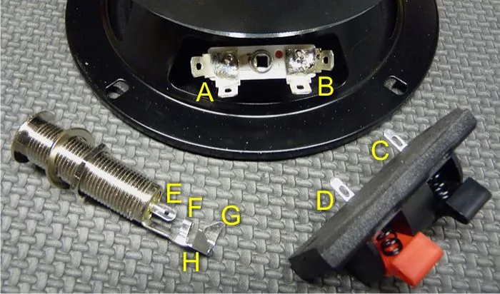

I've included pictures, and have labeled the various potential solder points.
If I were just using the red-and-black spring clips, I assume the wiring would run:
C ----> A
D ----> B
Correct me if I'm wrong (duh).​

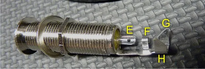

I'm confused about how to include the 1/4" jack. 'E' is obviously a solder point, but shouldn't there be a second solder point - F, G or H?
And...I don't know which wire--red or black--goes where on the 1/4" jack.
Please tell me how to wire this so I can drive the speaker by both the speaker wire clips and the 1/4" jack.
If you put it in simple terms like "C to E to A" I'll understand.
Thanks

F is the sleeve solder point and G/H are clamps for holding your cable in place.
Often there is no F and instead there's just a small hole.
For one input or the other, wire
A-F
B-E
or
A-C
B-D
If you put them in series like this
A-F-C
B-E-D
then you'll have the choice of inputs, but ideally you'd want to use a switching jack socket, rather than the pictured one, so that your two sources don't ever become connected together.
A switching socket would disconnect E-D and F-C when a jack is present, see?
When a jack isn't present, the socket just bridges the gap for you.

With 1/4" jacks the outer part (F) is always shield/ground and the inner connector (E+jack tip) is always the conductor.

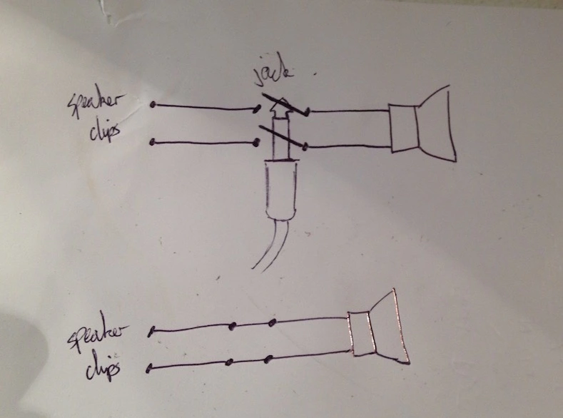

RE "4: A different approach" - What you describe is parallel wiring instead of series but it still doesn't address the issue of two input sources being connected together.
If you make a point not to connect jack and speaker wires at the same time then yeah, you'll be fine.
Like a lot of things, though, you only get to do it wrong once.
Here's a "diagram" showing the benefit of a switching jack.
Whether the jack is connected or not, only one input device is ever physically connected to the speaker, see?

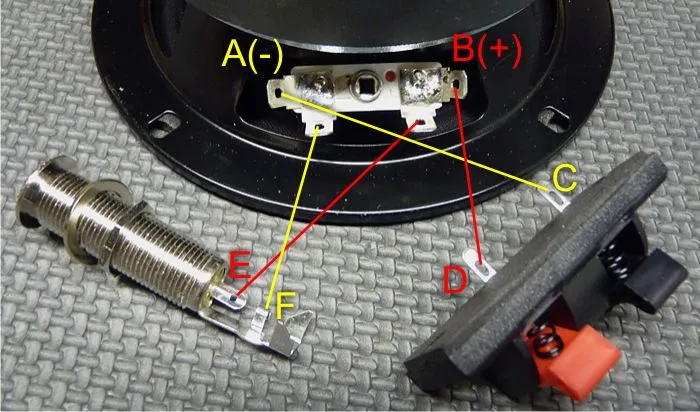

So this is what I'll do, wired in PARALLEL (if I'm wrong, TELL ME NOW :eek:)
Spring Clips
RED(+) D to speaker B1
BLACK(-) C to speaker A1
1/4" Mono Jack
RED(+) E to speaker B2
BLACK(-) F to speaker A2
Thanks for excellent clarifications, and yeah, I'm all too familiar with your caveat, "...you only get to do it wrong once." :facepalm: Let's see how my luck holds in this instance. :D

In short, it's not a good idea to have two input options wired up without some kind of switch but, if you're going to, ^ that's a fine way to do it. ;)
If you change your mind, you could use a DPDT switch for safety instead of a switching jack.
If not, you're set. :)
