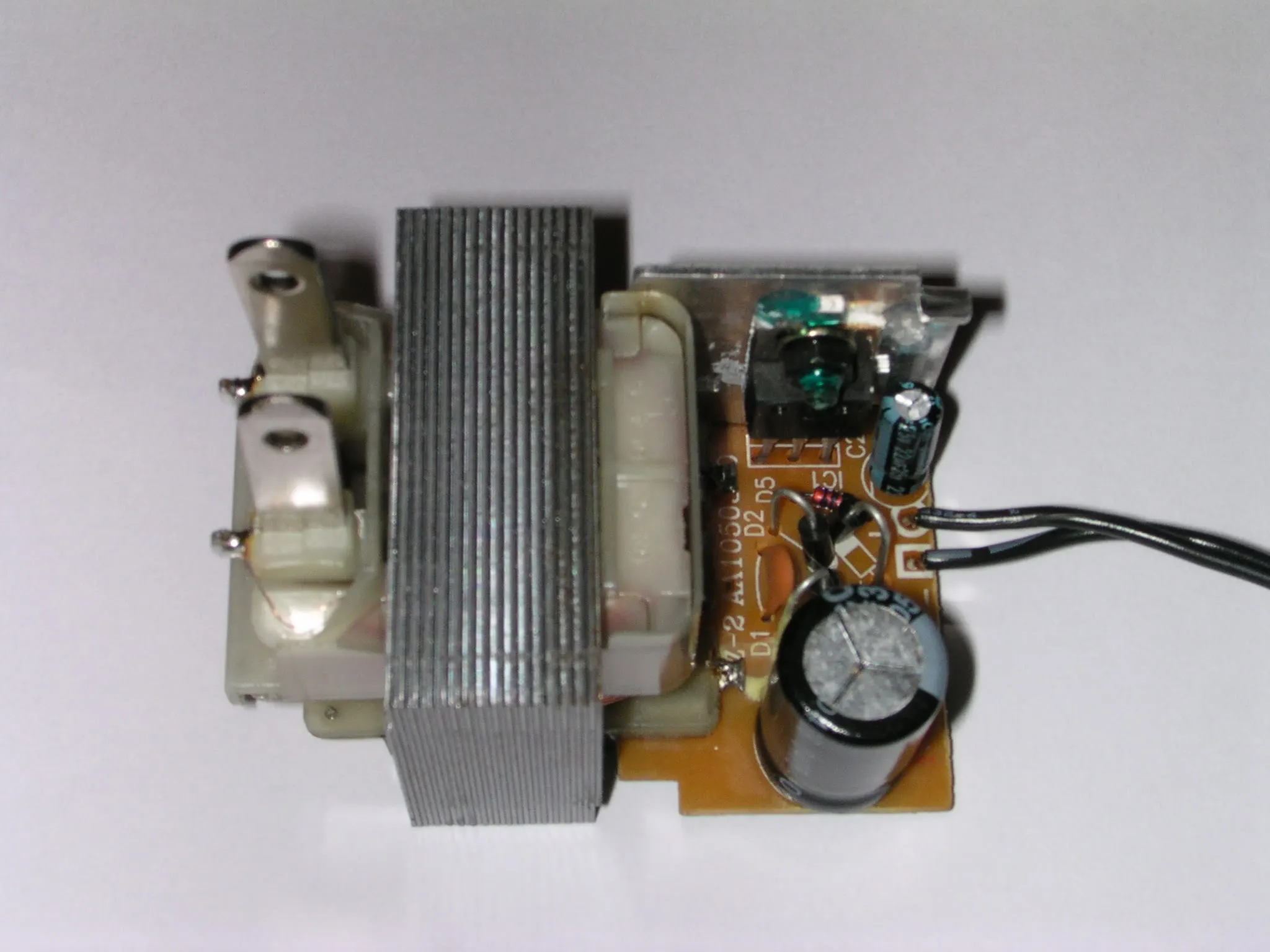

You seem to be disparaging batteries, but really they are almost ideal. Aside maybe from a tiny bit of thermal noise they are perfect pure DC. No wiggles period. A wallwart takes the wall power - wiggling back and forth either 50 or 60 times per second - uses a set of diodes to force it to wiggle only one way (but at twice the frequency), and then uses a capacitor as basically a low pass filter to try to knock down the wiggles to whatever the designer feels is "close enough" to perfectly flat. Some get closer than others.
Well designed pedals which expect to run off wallwart power will include some semblance of filtering inside to attempt to make up for deficiencies in the supply. The problem is, though, that in order to get enough filtering at a low enough frequency without introducing too much series resistance you need a really big frickin cap. And by big I mean physically large. The ones I use in my DIY pedal distribution boxes are almost as big as my thumb. It's tough to fit that into a typical wallwart or stompbox.
