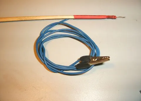

This is what I use. There's a 100k ohm resistor on the end of the chopstick.
That's a pretty slick little tool. I'm gonna go make one!
Does the alligator clip just connect to chassis? Newb question! Also, has anyone done an isolation transformer install on a Supro Bantam?
Yes, the alligator clip connects to the chassis. I like to use test leads with alligator clips on the end. I cut the test lead in half and solder a 100k or 150k resistor between and cover it up with heat shrink. One side clips to the filter caps and the other clips on to the chassis. Drains in seconds. **Word of caution, DO NOT FORGET TO REMOVE THE CLIPS WHEN POWERING UP THE AMP**. I like the chopstick one, gonna have to make one of those. :)
