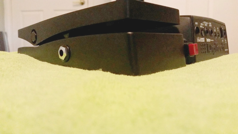

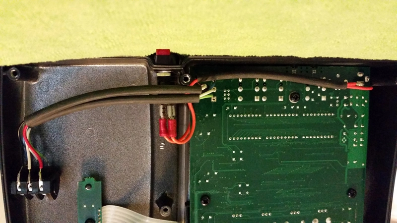

I have a Digitech RP255 pedal that for me was a little cumbersome to use the way it was. So I decided to mod it.
1. There's no switch so I installed one on the back from Radio Shack - The input jack is a switching jack and since I leave the cord plugged in I didn't like having it always on so it was removed. The switch could be put next to the new input as well.
2. The input was on the back side where the guitar cord could easily end up under the pedal. So it was replaced with a non-switching jack and moved to the right side where most boxes have them. I would have preferred it directly in front but there isn't enough room to put it there.
3. Electrical tape was placed on the inside bottom cover under the new jack to prevent any shorts.
