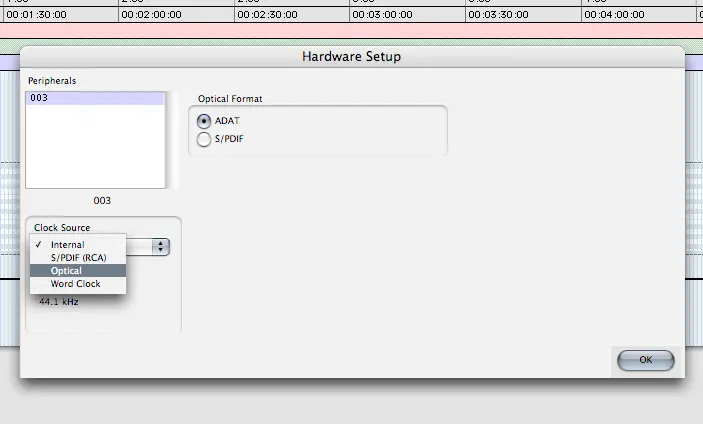

Make sure the sample rate switch on the back of the ADA8000 is set to the same sample rate of your Pro Tools Session.

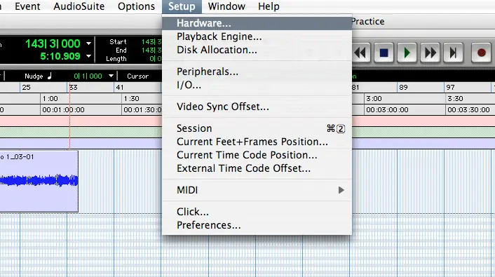

You need to set up your ADA8000 in the Hardware window under the Setup Menu in Pro Tools LE.
1. Set your Clock Source to "Optical"
2. Make sure your optical format is set to ADAT
That should do it.
Here are some pics to help you.

Wouldn't you want the ADA8000 to sync off the Digi 002? I know I would.
Make sure that the ADA8000 is set to "slave" and "ADAT In". You do this with the switch on the rear panel.
Then go to the ProTools window that Goodland took pictures of and set the 002 to "internal".
Double check the ADAT cables to make sure they are going to right places.
That *should* work.

Yes, that is a much better way of doing it. Either way would work, but SonicAlbert's method would be much better. My Bad:rolleyes:
