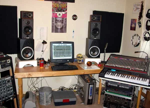

I was browsing the show me yours type thread there. and a common thing in alot of the pictures of home setups are panels and what seems to be foam padding on the walls.
now I've see this before, and I know what it's used for... for the most part. however I'm just curious as to what the material actually is, and where I can get these things.
heres some pics to reference what im talking about,
NOTE: THESE ARE NOT STUDIOS OR MY PICTURES, THEY ARE TAKEN FROM THIS THREAD: https://homerecording.com/bbs/showthread.php?t=70931
In the first pic there I noticed the padding on the walls. that looks like general use packing foam that you sometimes get in boxes of fruit. is that what that is?

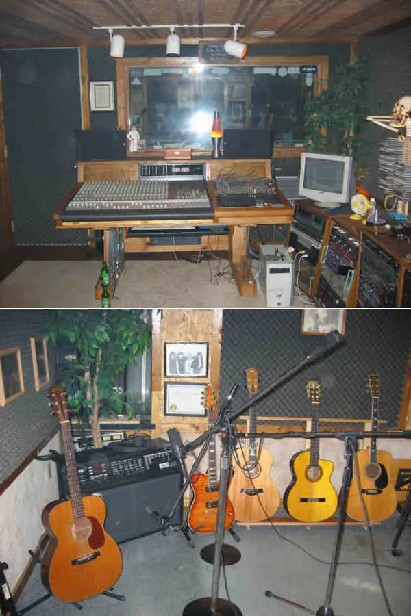

In the second pic there seems to be curtains behind his studio monitors, i noticed curtains behind or around monitors in other pics as well. why is this?
I'm no acoustics expert but it looks like auralex or some other type of foam to tame high frequency reflections. Probably for tracking, or both tracking and mixing.
High frequency reflections can cause nasty reverb sounds on recordings, especially for acoustic instruments.
I don't see curtains? :confused: They look like absorber panels hung or mounted onto the wall.
Absorber panels are usually made either 2x4" or 2x2" depending on what frequencies you want to absorb. OC 703 rigid fiberglass is usually used, or rockwool/mineral wool.
