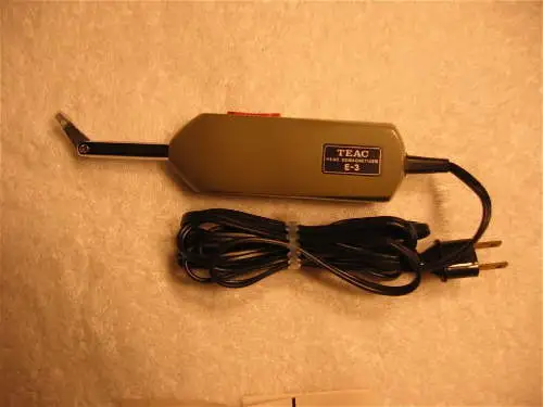

HAve a look out for a secondhand TEAC E-3, they came out about the same time as the 3340, I got one in a TEAC maintenance kit with cleaning liquid, splicing tape, small screwdrivers etc, that came with my 3340 when I bought it.
Alan.
Found this pic on the web:
