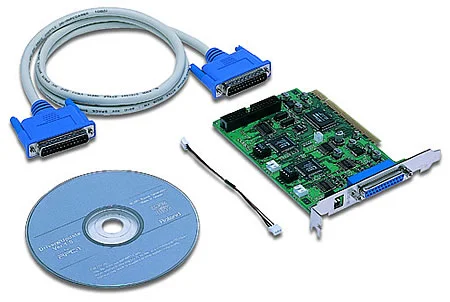

RPC-1 form factor?

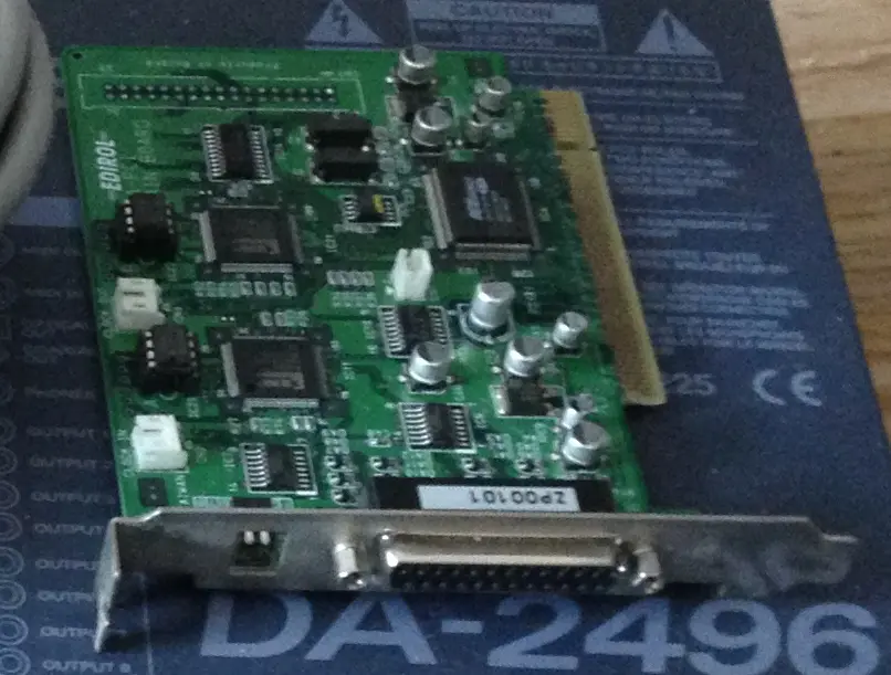

Is the RPC-1 PCI, PCI-X, or PCIe?-I'd like to know because I have a DA-2496 and I love it and want to keep using it. You all may already know this, but you CANNOT use the DA-2496 with a dual processor system-Thanx!-Ciao!
Thanks for the new Windows 7 info! Im goint to try it, and if it works for me it will add alot more performance from my daw. and as for using the DA-2496 with SMP, I have a dual opteron 64 dual core system running 4 DA-2496 cards. I am currently still on driver 1.02 as 1.12 destroys mulitcard support.

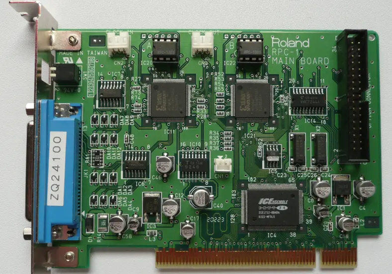

apparently the card that the da-2496 ships with .. in fact.. IS an RPC-1 only its labeled as a "DA-PCI" but they are identical other then the blue vs black colouring on the db-25 connector..
Screen shot 2014-10-22 at 3.55.56 PM.webpScreen shot 2014-10-22 at 3.58.35 PM.webp
another note:

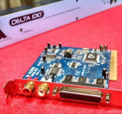

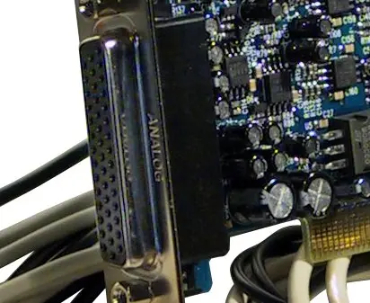

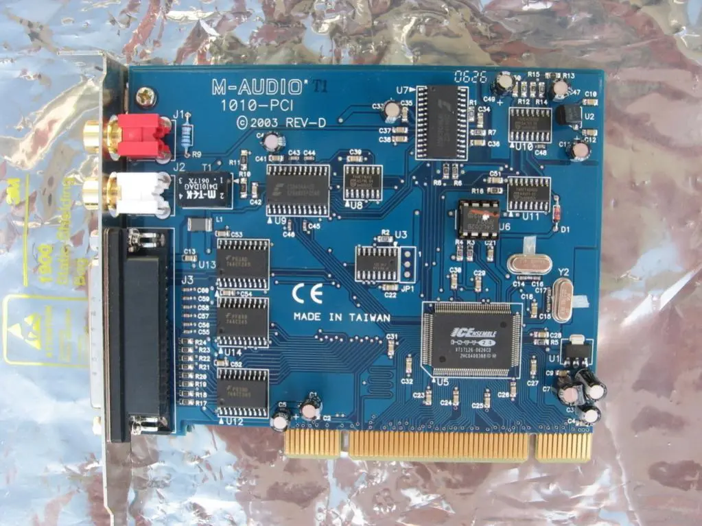

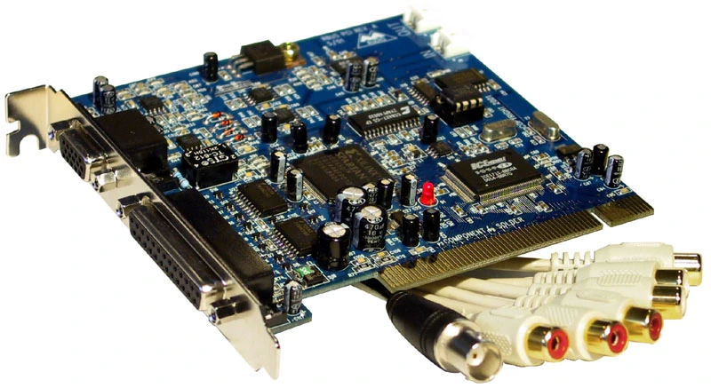

the db25 connector physically matches that of the original Delta 1010 (2 rows of pins) but not the Delta 1010LT... (3 rows of pins)
but this is of little use as i dont think it uses the same pinout..
that is.. u cant for example take a complete Delta 1010 rack unit + attach it to an RPC-1 ...
and vice versa.. take a complete DA-2496 and attach it to a Delta 1010 (non-LT) pci card...
at least.. im guessing this is impossible..
if someone owns both systems. perhaps they can verify their compatibility/incompatibility.
