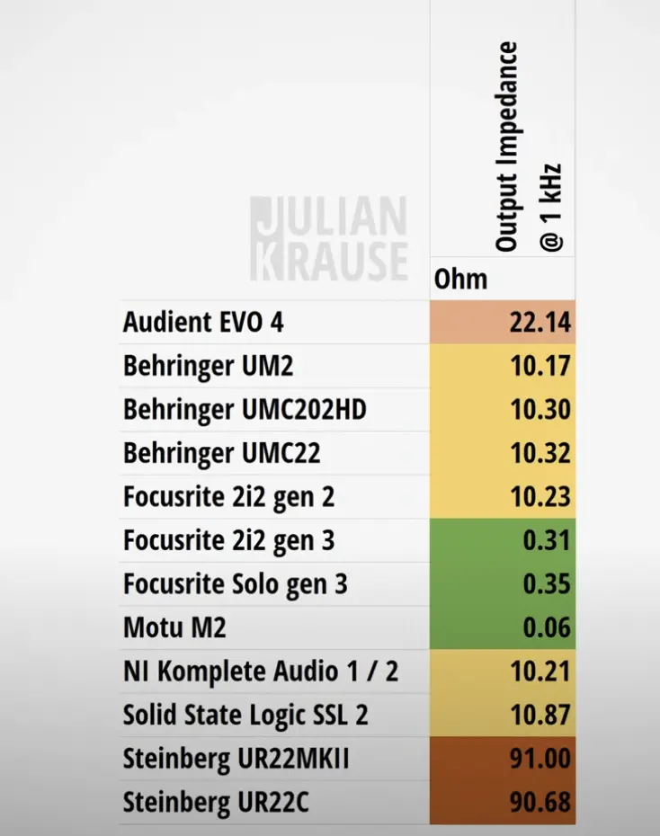

This YouTube channel by Julian Krauss has been revealing. Many of the interfaces I've wanted to buy because I thought they'd be great are no-gos now. Though, I'm looking for something pretty specific. This video in particular was really helpful (screenshot is below)
This is a readout of the headphone output impedance of a few common interfaces. What I've learned is that output impedance can be multiplied by 8 to roughly determine what headphone impedance will work well with the interface (it's not perfect, just a ballpark, but the closer to an exact match the better).
The closer the HP out is to zero ohm, as long as it has enough power, the more hifi headphones it is compatible with and can drive with a linear response instead of scooping the sound due to impedance mismatches.
A friend of mine loaned me a Steinberg UR22 Mk2 to use for recording on my Mac while I figured out what to do about getting a new audio interface. I'm thankful to have something, but man the UR22 mk2 is not great haha. The preamps are noisy, the channel balance is wonky on the outputs, and the HP output has an impedance of 91 ohm. That means the lowest impedance headphones that can it can supply with Flat frequency response and the tightest bass response is: 91ohm x 8 = 728 ohm.
Insane.
Now this doesn't mean that a 250 or 600-ohm pair of audiophile headphones won't sound good, it just means that the impedance mismatch will colour the audio signal. For mixing, it's not the worst if you're using 250 ohm headphones. But for mastering, I need the cleanest possible audio signal with no colouration, and inaudible levels of distortion across the frequency spectrum. As I've learned, this is why the likes of entry-level Lynx or Antelope interfaces start at over $2000 USD.
But I may have found a gem. The MOTU M2. It does have some harmonic distortion issues at certain volumes but overall doesn't seem to be all that noticeable. The frequency response is linear on all outputs, and the headphone out has an impedance of 0.2 ohms, near-perfect channel balance, excellent cross-talk, and transparently clean and quiet preamps. I've never used Motu Interfaces before, so I'm curious to know if anyone has experience with these, or what other interfaces people are using for mastering
