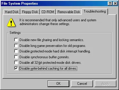

Monkey Allen said:
... disabling 'write caching' on the HDD. ...
From the error message you quoted, it sounds to me like this would be a good thing to try. Don't know XP, but on 98SE it's done from the "File System" options on the "Performance" tab of the System Properties control panel. I've attached a shot of the relevant dialog. HTH.

I would be very careful abpout disabling write caching. Not only will slow you OS noticably, it is treating a symtpom and not the cause.
In my experience. thiese errors generally indficate some sort of hardware problem.
