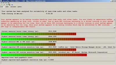

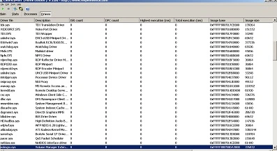

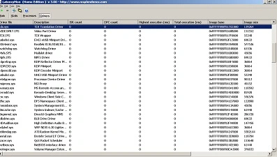

I am having some serious issues with crackles and pops in SONAR 7.02 rewired to REASON 4.0 in WIN 7.I attached
three "LATENCYMON" screenshots. HAL.DLL, NTOSKRNL.exe .... These are things I cant EEEEFing disable.I have spent
countless hours over the last 2 weeks trying to get this to work ..
I have read every article I can find and searched most forums. Note that in Latencymon maib page view that the highest reported hard pagefault count was always redlined. here it is not. i disconneted my samsung LCD TV and it seems better (where it is now).
