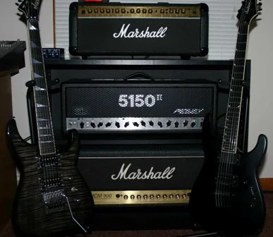

Metalhead~ What is in your guitar rig?
What is your process for capturing decent metal tones?
My guitar rig is right here in this pic :D

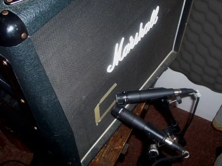

My guitar process would involve 2 mics on the speaker like the below pic.
I track two performances with the 5150 II and pan them hard right and left. Then I'll usually track 2 more performances with a different tone on the amp or with a different microphone (usually a Sennheiser e609s). I always record a DI track along with the original performances. Sometimes rather than record 4 or more seperate performances I'll just use that DI track and re-amp the first two performances through the other amps or through the 5150 with a different tone dialed in. For differing tones I'll usually do one with a pretty low gain really clear sound with alot of midrange, and I'll blend that with a higher gain sound with maybe more low-end. From there I'll just use the characteristic sound of a different amp. I often end up cutting the low mids (around 400-500 Hz) to get rid of some of the mud that you just can't dial out of the amp. Also when recording multiple tracks that range has a tendency to really pile up.
By the way, the tape in the picture is marking the center of the speaker. I put the on axis mic right in the center. I also don't like the sound of distant mics so much.

By the way, I don't think there is any replacement for power tube distortion. I'd rather record with the pre-gain on 3 or 4 and crank up the power section on my amp to get a really heavy sound. Especially when layering stuff alot.
That said, I usually record with the pre-gain on around 3-5 and the post gain around 5 to 7 (sometimes more).
For lead guitars It's a different game altogether. I'll record a single track with probably 3 different mics on the cab along with a DI track. That first track will have loads of gain and volume so that I can play with the feel and the sound that I am inspired by. I'll use the DI track that I record with it for re-amping with a couple of cleaner tones to lay underneath the original track. That is a good way to fatten up a lead.

Nice choices there metalhead.
My choices are rather limited of late, either crate or DI via Sansamp GT2. :o
Not that I've had time, nor inspiration to record lately though (given circumstances above).
Don't suppose you know of a good smallish tube amp, somewhat easy on the wallet that might produce "decent" results for tracking? :confused:
If not, how about "not so easy on the wallet" variety?
Mesa just seems like such overkill for me (wattage and $), though that self-biasing tube feature is a selling point for me....
