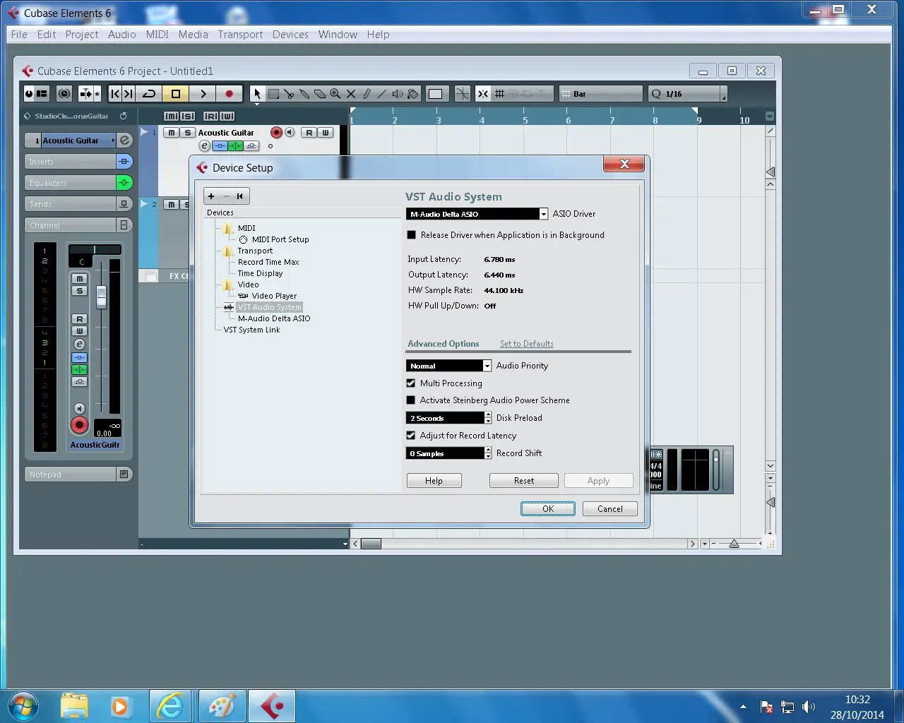

My Cubase (le6) shows M-A Delta of course but yours should show the AI.

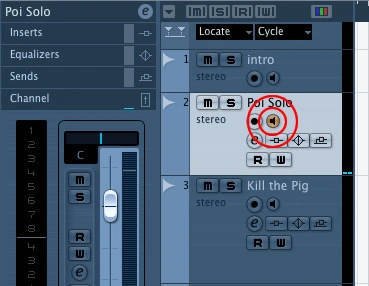

See that icon that looks like a speaker right next to the track arm (record) button? Toggle that. You should get playback if your output is set correctly. :)

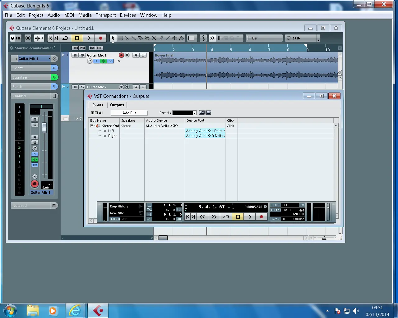

Have you got output busses setup as per the diagram?
Once again it will be YOUR AI in the box not my Delta 2496.

When the icon was lit, you should hear the incoming audio through the outs, but to replay the tape that needs to be off.
