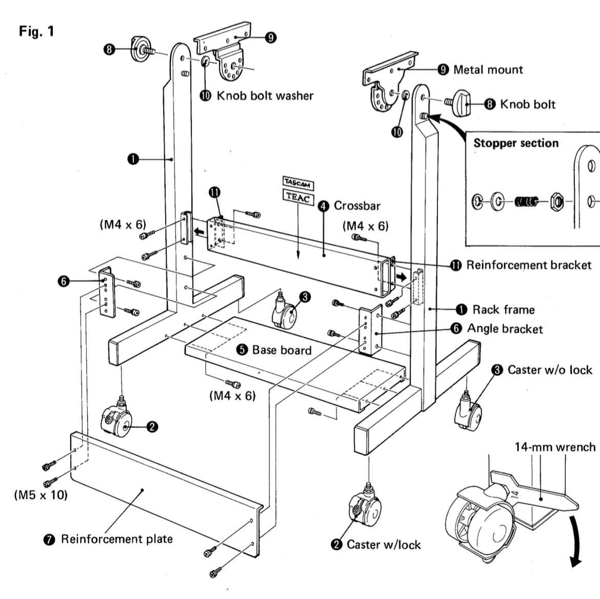

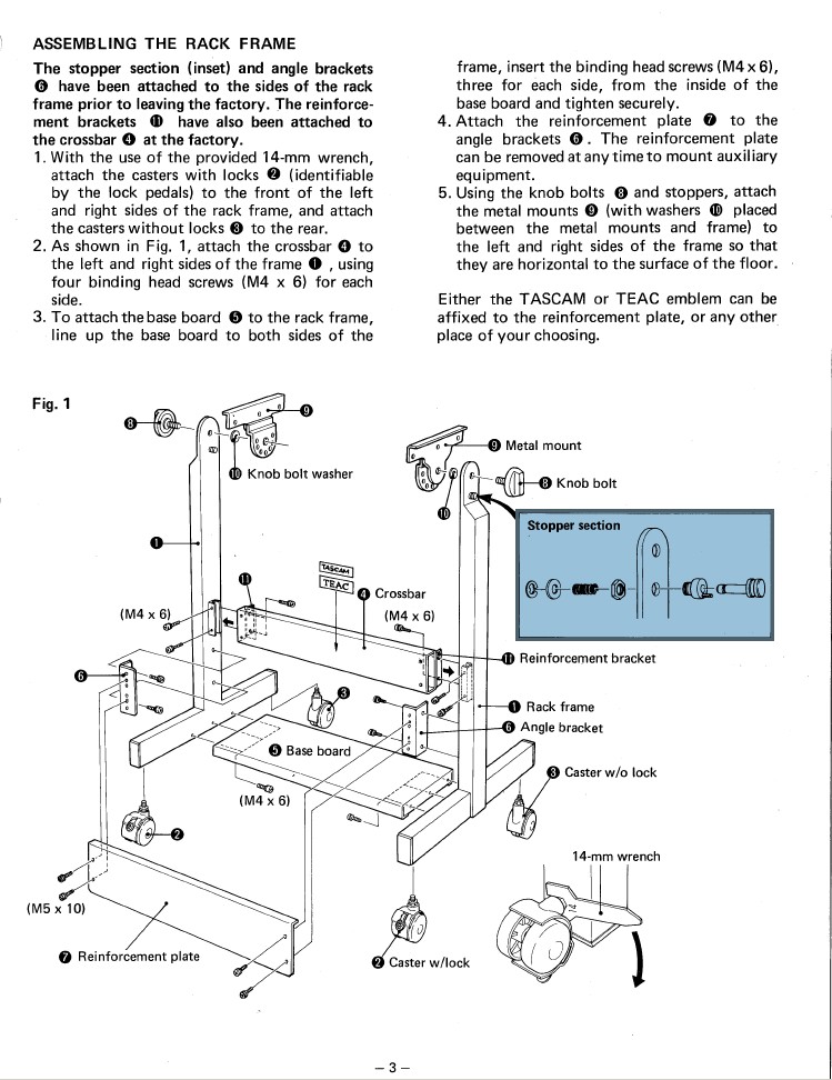

Here is a pic of the locking pin assemblies that are missing from my unit:
And here is a shot of the vacant holes for the locking pins:
