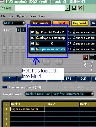

You only need to insert one Vsampler track. You can add several sf2 to build your own "multi" using patches of different sf2. To do so, make sure you expand "import" field. Click SF2 to import first soundfont. Once selected, the import field will show you patches contained in the sf2 selected. Double click the patch to upload the patch to multi. After it's loaded into multi, make sure you lock it. Now, select another slot on multi (eg. slot 2). Browse another soundfont to load. Do the same procedure. If you do it right, you can have up to 16 patches loaded in curent multi.

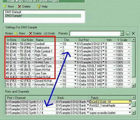

Lets see if I can help. Using Drum maps with Vsampler involving setting on both VSampler and the Drum Maps configuration. Config VSampler first, then create drum maps later. Okay here we go...
First, I assume you already have sample project with drum track to try. Load it. Done? Great! Now, insert VSampler DXi on new track. Load soundfont (for example) GoldDrums.sf2. Load to patch 1 on current multi... you got it, eh? Great! The padlock will turn orange automaticaly, indicates it's locked now. Then browse another soundfont to load. Say BlueJayDrums.sf2. After you select it, you'll see it contains many patches within the sf2 bank. Select one, double click to load it to patch 2 on current multi. Lock it... it's not that difficult, right? :)

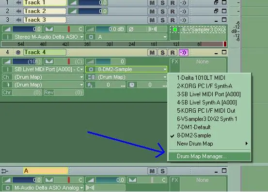

...Close VSampler. Now, open Drum maps from track's out field.

Now that the Drum map is open, you can assign each input key to particular out key (Red line), and port / channel as well. You must set different channel for each patches you use. Once you select different channel, you can assign different bank / patches on the field below it. So, for each instrument you use, you must use asociated channel.

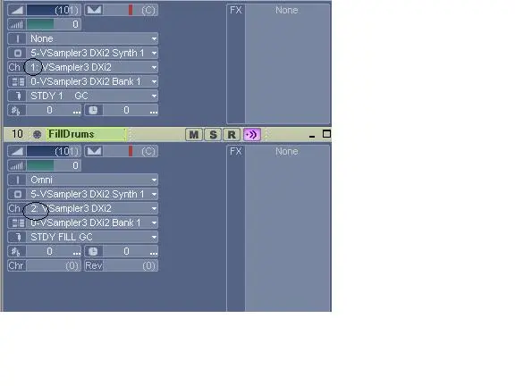

but the thing I did wrong was the following
As you were stating I was adressing the same vsampler channel tru my midi tracks ..
unlike depicted here .. i was adressing channel none on both tracks ..
SoI guess I moved a step forward ...
