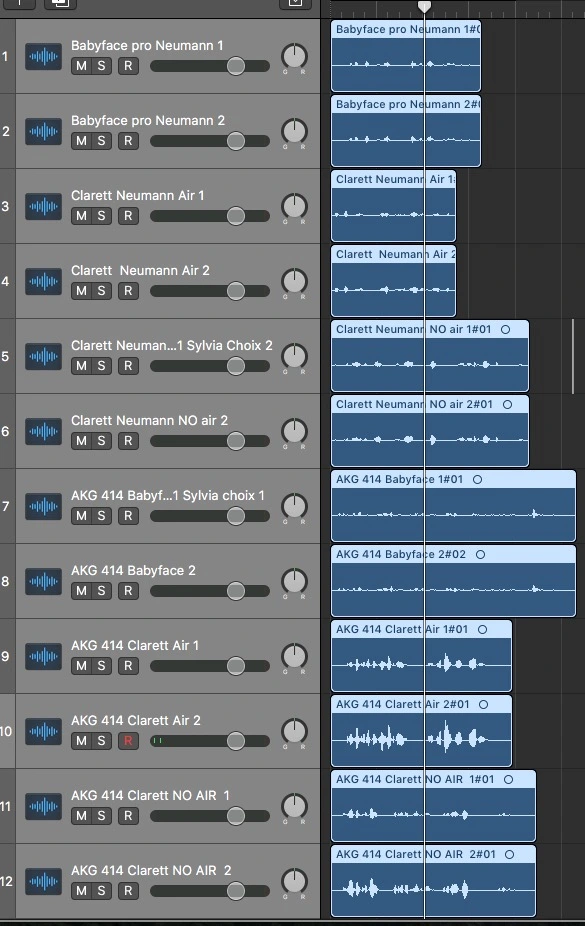

Cracks, buzz and other with Focusrite Clarett 4 Pre and thunderbolt on Mac.

That's odd, Marias.
It sounds like some sort of digital glitch, but it's isolated to only two microphones?
Just clarifying some more - If you were to hit record with four microphones plugged in then wait for the glitch,
would it appear as a recorded glitch on only two of the recorded tracks?
If that's the case, I'd be wondering if the microphones are near anything that would be causing intermittent interference.
Just quoting this in case it was missed.
If the issue was on every track I'd be looking for some sort of global glitch but if it's isolated to two microphones I'm more inclined to thing that those microphones are picking up some sort of local interference.
All your XLR cables are XLR-m to XLR-f, balanced, yes?
Oops maybe I should check that ALL the cables are balanced. I have a bit of a mixed bag. Thanks all of this is sort of what I thought. I'll let y'all know the next recording session if this appears again. The KLM's were on a high perch so maybe more subject to interference compared to the AKGs (tried to send a photo but YES the site is on the fritz...)

I haven't read the whole thread, but this setup is similar to mine. I have a mac and a Focusrite Clarett 8 Pre. I've had some clicks and pops in my recordings. What I did to get rid of it was to put my cell phone about 20 feet away.
