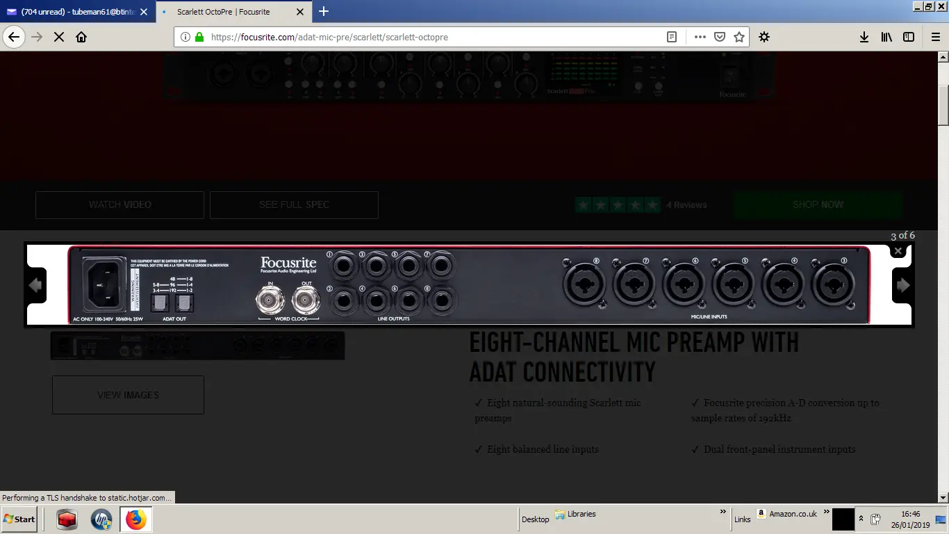

JUST a cotton pikkin'!!
What are those jacks on attached?
Those are for analog in/analog out. You could use that unit as a standalone 8 channel preamp, as far as I know.
My understanding is that OP wants to output 18 analog channels from his interface.
To do that, he'll need an 8 channel D/A converter.
Doh! Got it. No optical INPUT.
