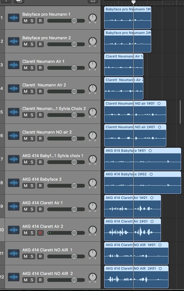

Here is the audio of one of the many instances :

It sounds like some sort of digital glitch, but it's isolated to only two microphones?
Just clarifying some more - If you were to hit record with four microphones plugged in then wait for the glitch,
would it appear as a recorded glitch on only two of the recorded tracks?
If that's the case, I'd be wondering if the microphones are near anything that would be causing intermittent interference.
