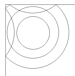

It's not just 90 degree angles. It's any angles.
There are problems close to any boundary, but in the corners there are two boundaries. So the wave is able to reflect onto itself in both directions and cause peaks and nulls (as below). This is happens more-so with bass frequencies as they are omnidirectional and far more powerful (they last much longer in a room).
