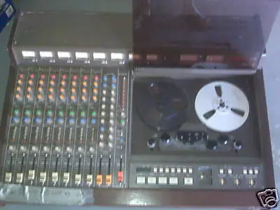

You've defined your goal as recording live bands to 8-tracks. That's easily doable with many different analog setups. The Fostex line of 8-track reel recorders would do the trick, (A8LR, Model 80, R8), but the "classic" A8 records only 4-simul, so would be off the list of viable units. The Fostex units record on 7" reels of 1/4" tape, which is a budget medium and is still easy to get. People consider the 1/4" 8-track medium as a compromised, home-use format that somewhat limits the high fidelity aspect of the recording, but with proper technique this detriment is limited or almost negligible. However, the 1/4" 8-track Fostex reel decks are smaller and more portable than a more massive 1/2" reel 8-track format from Tascam. Portability is also one of your key requirements. The Fostex R8 is not only the most modern of Fostex 1/4" reel 8-tracks, but it's scoped for easy portability with a built-in handle on top. The problem with Fostexes is that if you run into more difficult maintenance problems, repair parts and support are almost non-existant. However, easy maintenance such as a rubber drive belt is more universally available and moderately easy to replace as DIY.

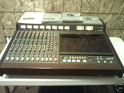

Tascam made one 1/4" 8-track, the 388, and it's a gem. It's actually a recorder set in the deck panel of a mixer, and thus is a self-contained solution. The 388 is highly regarded in inside circles, and is a real fine unit in many respects. If you get a properly working 388, you get to skip ahead directly to the tracking phase. The 388 will do 8-track simultaneous recording and the mixer section is top notch. It's hard to go wrong, but I don't want to pidgeon hole you immediately with that option,... tho' it's a good'un.

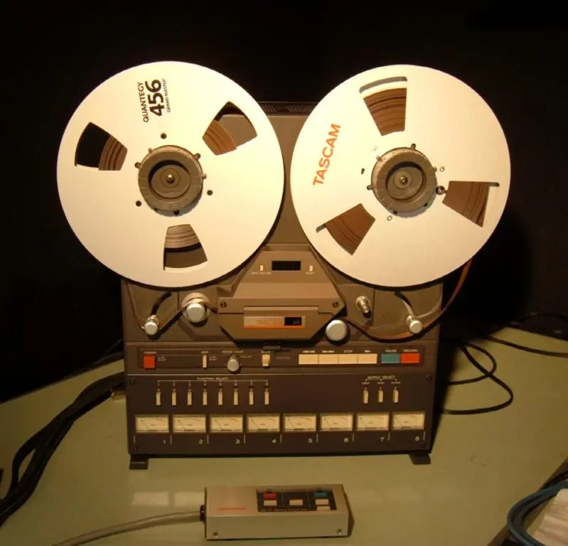

Tascam made a few 1/2" reel 8-track recorders, but I'd focus mostly on the 38 and TSR8. Being larger, they're accordingly less portable, but it's doable for remotes. 1/2" reel tape is still available, but way more expensive than 1/4". Still, a 38 or TSR8 is a fine basis for an 8-track recording studio, if you're inclined to go that way.

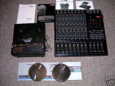

With any standalone recorder, you'd need an appropriate recording mixer to go along with the recorder. The field of qualified mixers is a bit more wide open for choices. Several choices from Fostex and many from Tascam.
You might be best served to find the scope of your recorder before you start browsing mixers, but F/I, there's the Fostex 450 or Tascam M30, M200-Series or M300-Series. For the big guns you'd look at the Tascam M512. Anything larger than a 12-channel mixer and your beyond the "easily" portable range of mixers.
Depending on what city you live in, dictates local availability of equipment like this, but local pickup is always preferred. Many decent recorders have met their fate in UPS shipment. Beware.:eek:;)
That's all for now. Good luck!:eek:;)

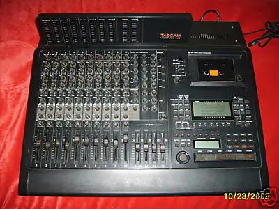

What I really wanted to say in this post, is that you may be best served to get either a Tascam 688, 8-track cassette Portastudio that records 8-tracks simul thru the built in 20 channel mixer,... tho' if you get this make sure you get a manual with it for operation! It's more complicated right out of the box than most other multitrackers.

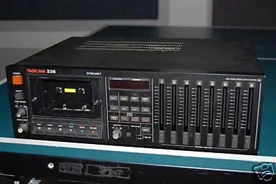

Also, along the same lines is the Tascam 238 Syncaset, a rackmount cassette based 8-tracker that requires an external mixer, but is a real performer in this midline category of recorders.
The 688 should be considered because it's highly functional and still portable and self contained,... a real boon for remotes. The 238 is a bit more like any other standalone recorder, but being cassette it's a lot more economical and accessible than any reel recorder previously mentioned.

Yeah, the 688 is cassette-based, but don't sell it short...you'd be surprised at the quality of recording you can do with that machine and it has many very "modern" features that would be helpful to you on-location like user-defineable scene presets for mixer routing and such to go along with the scene library...built in MIDI sync too...not that you mentioned that, but with a MIDI interface for your computer (really cheap if you don't have one already) you can sync the 688 to your DAW. And media is widely available and cheap (relatively speaking). If you are looking for samples of what can be done on these Tascam 8-track cassette-based units, I might be able to get something posted up...a band I was in in the early 90's did an entire project on a 488mkII...lesser kin to the 688...A Reel Person would have suggested it but it also will only record 4 tracks at a time.
The R8 plus a mixer could be a great option too, but heed the concern about parts and service...not there. I've heard some amazing stuff done on a Fostex 1/4" 8-track. Just keep in mind the cross-connecting you'll have to do with separate mixer and recorder/reproducer.

At the tape speed of the Fostex 1/4-inch machine, and the reel size it accomodates, you get something like 17 minutes of recording time PER TAPE. You would be changing reels every other song- hassle and cost would go way up, even using cheap tape. And just try to imagine the scene- the band is paying you for a recording, you are missing audience reaction to every other song, maybe having to wave to the band to hold up for a bit while you chase the reel that rolled off the table and down to the street...

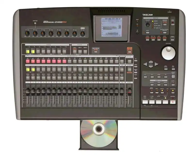

There's something to be said about scoring the digital Tascam 2488 if u really need an upgrade. The 2488 records 8-simul to hard disc and has all the convenience of a Portastudio. Just $700 convenient for the 2488mkII and $800 convenient for the 2488neo. It gets you tracking right out of the box with a self contained and portable unit.:eek:;)

Yeah, I know it's cassette but anything other would be just a pain to log around town.
Now, if you don't wanna go cassette [and something tells me you won't], then go for a digital multi-tracker.
I don't really want to go the cassette route because (I know it's not professional cassette but) my first record experience was with a cassette recorder and the noise bugs the hell out of me and you can't really get the same warmth you get from tape (as far as I can tell) which is basically the only reason (besides the gear lust) that I would want a reel to reel set up.
Yes, cassette decks can sound terrible, compounded by bad maintenance BUT have you ever recorded or heard something off of a legacy TASCAM 4 - 8 track cassette recorder? You'd be surprised.
I, honestly, would recommend you pickup a nice 244 or 246 and maybe a 688, for an all in one solution. No noise, fantastic recordings. Stay clear of shipping though.

After listening to some of those songs recorded on cassette on Soundclick the Tascam 688 is looking like a very enticing option. Honestly sweetbeats the only reason I've really looked at the Tascam DA line is the portability, cheap cost of the hi8 tapes, and that no one in my area sells this kind of stuff and they sell for decent prices on ebay fairly often. Given the maintenance needed with reel to reel recorders and the price of tape the Tascam 688 looks great since it has the amount of tracks I need, cassette tapes aren't expensive and if it sounds as good as the lower track count recorders that guy on Soundclick has used then it has great sound quality so right now that's what I'm mainly looking at.

The 688 is a way-cool unit as far as cassette goes. The mixer section is quite flexible. The 688 beats the pants off of a 488 in that arena.
