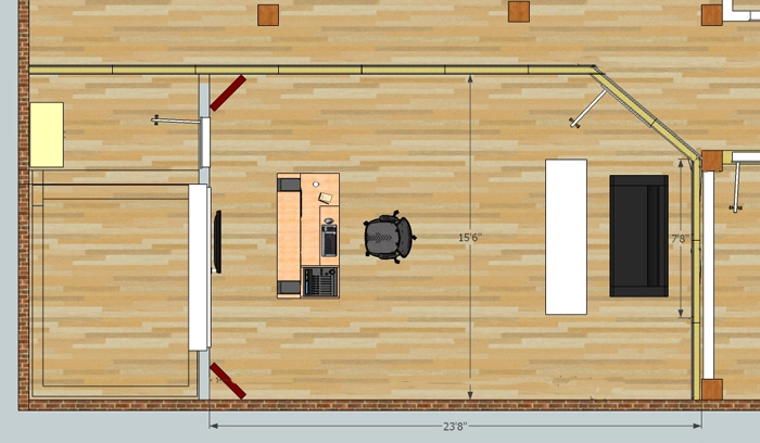

My main question now though is about rear wall symetry. Due to the layout of the space, I will need to build an angle into the corner of the rear control room wall (around 45 degrees) to allow passage on the other side. This wall will also have the door to the control room in it. My question is, given that one side needs to be angled, is it better to duplicate this angle on the other side, or is it better to keep as much volume as possible in the room?
I would think symmetry would be important even in the rear, but trapping will be trickier the more angles I have and the loss of space isn't the greatest...
So I guess my question is: which is the lesser of two evils?

A great sized space definitely! I think I would suggest using the angle, certainly. You still have the area behind the couch between the two angled walls for some very thick absorption to get down to the low frequencies. Have you thought of hiring an acoustician to design the space at all?
With both 45° angles you're going to have a bunch of reflections aimed at the couch. You can treat down to a point but anything below the treated range will build up pretty badly at the couch. On the up side it may placate clients with a tendency to over mix bass frequencies.
I would get the monitors off the desk and onto stands at an appropriate height.

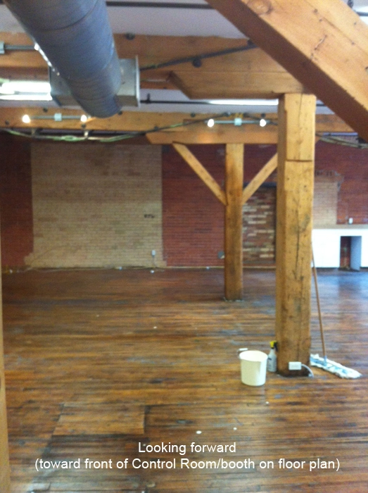

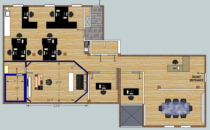

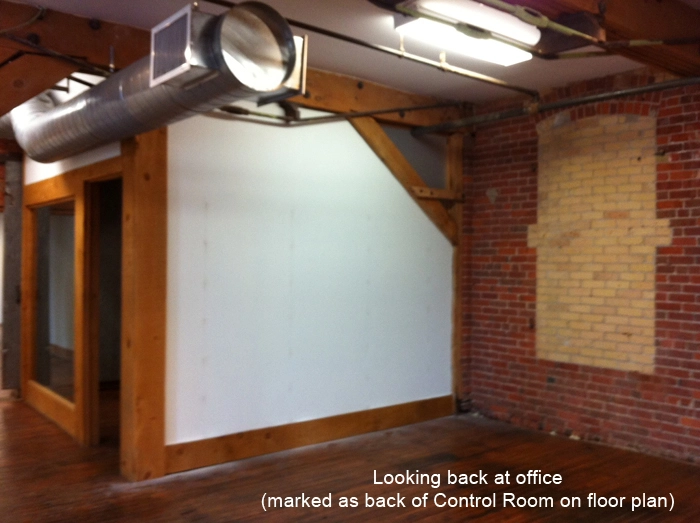

Just to give a little more context, here is a floor plan of the full office (the blue walls are the proposed new build walls) and a couple photos of the space...

One other thing. I see a large supply duct feeding different spaces. Are you changing that? You should. It's a perfect common flanking path for sound to transmit from and to other spaces.
