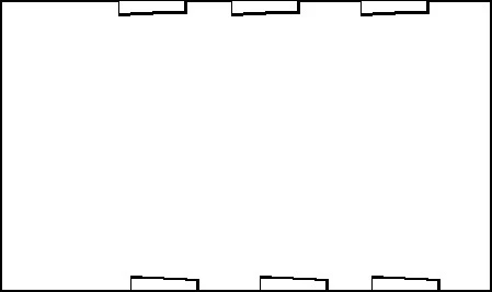

Yup - mirroring like that is the way to go. Alternative would be to build some angled frames for the side walls to break up the parallels.
cheers
john
Like this:
cheers

ok John,
So you are saying I SHOULD make the left and right walls mirrored images of each other?

wow.. cool... nice fast response with the picture John :)
What if I were to take these foam peices and slant them by putting another peice of foam under one edge... so it would look like your drawing, but there would be space behind the foam?

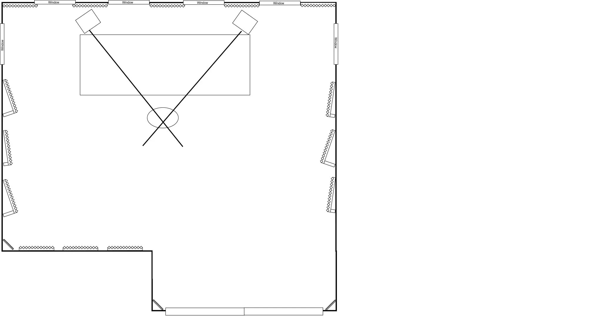

I've attached a picture of what I was thinking of doing.
Notice that the foam on the side walls is angled by placing another piece of foam behind it... this leaves a void behing the sheet of foam... is that a problem?
I also have two different angles for the foam... one taller than the other. I alternated them on opposite walls.
Thanks for the help... let me know what you think.
Velvet Elvis

Yes but.
1. the angle should be the other way as I drew in my pic. 6 - 12 degrees.
2. There must be a rigid surface creating the angle so use MDF and place the foam over it.
cheers
john
John,
So in your drawing the left hand side is the front of the room?
Thanks for the info!
