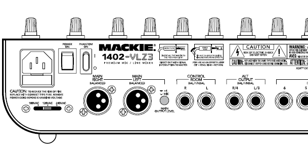

Yes, I tried that, but something seems not right. let me check again. I have attached a screen shot of the top side of mixer where I have the speakers plugged into. In the ALT OUTPUT R/4 & L/3. See image attached. This is correct right?
If so, then which mute button is associated with that ALT OUTPUT outlet?
That seems like the right place to connect.
The Mute button doesn't just mute things, it reroutes them to the Alt 3-4 output. It will bypass the master fader and control room outputs, so you'll have to use the channel fader to control your volume.
