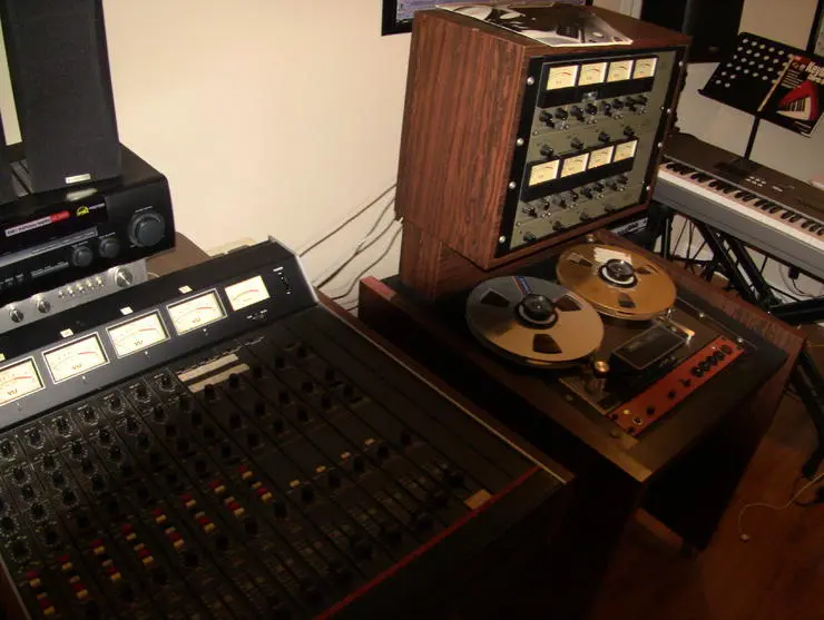

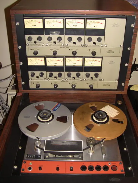

I just got this Tascam Series 70, 8 track reel to reel. It is matched with the Tascam series 5 mixing board that you see in the picture. All connections made between these two are RCA plugs. I am looking to utilize this unit on occasion with my Protools setup, which is basically a Digi002 interface and my MAC. I would really like to take the Series 5 out of the lineup since it takes up too much room. I am unable to get any line levels from this unit to my Digi. I am able go out of the Series 5 into my PA mixer with no troubles.
Any thoughts or suggestions would be greatly appreciated.
Thanks
Todd

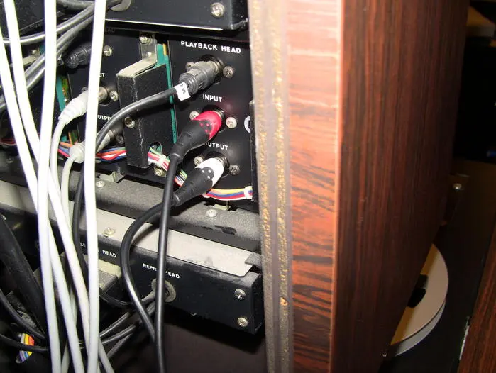

Some additional info. The only connections on the back of the Tascam Series 70 is an RCA in and out for each of the 8 Tracks.

Thanks for the reply, Sorry the pic link didn't work, I think these are now attached.

Have you verified that the 70 deck outputs signal? You should have some level. It's optimized for -10db operation line level. Crank the output knobs on the 70 electronics and make sure it's in 'safe' mode and 'playback' selected...
Yes, the 70 series has an output signal to the Series 5 board, which I then can run into my preamp, recording in Protools. What I would like to do, is bypass the Series 5 board and record directly into Protools.
Todd
Just plug the outputs from the deck into your PT converter's analog inputs....not sure why you are not getting any levels at the Digi? If the deck sends signal to the mixer...it should send it to the Digi...of course, the RCA outs are probably -10...so you may need to adjust afor that at the Digi.

I got the new Quantegy 456 reel today and started to play around the unit.

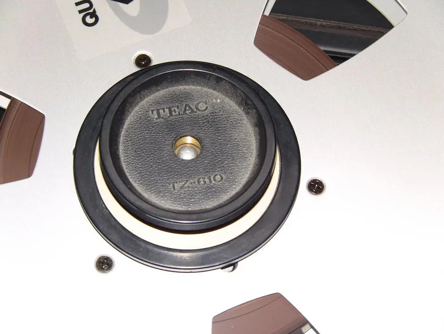

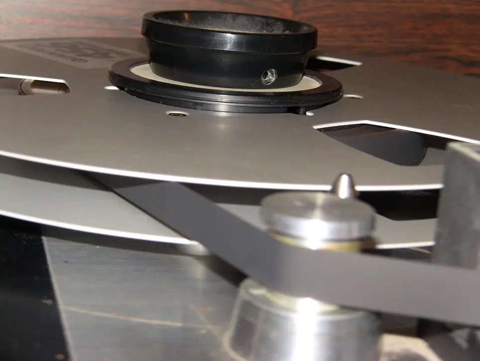

I notice that the new tape reel's tape is rubbing on the upper part of the new reel. So I am guessing this is a tape alignment adjustment? I took apart the screw down mechanism (it has a number of TZ-610) that goes over the reel, but I can't figure out how to adjust this? Here are a couple of pics.

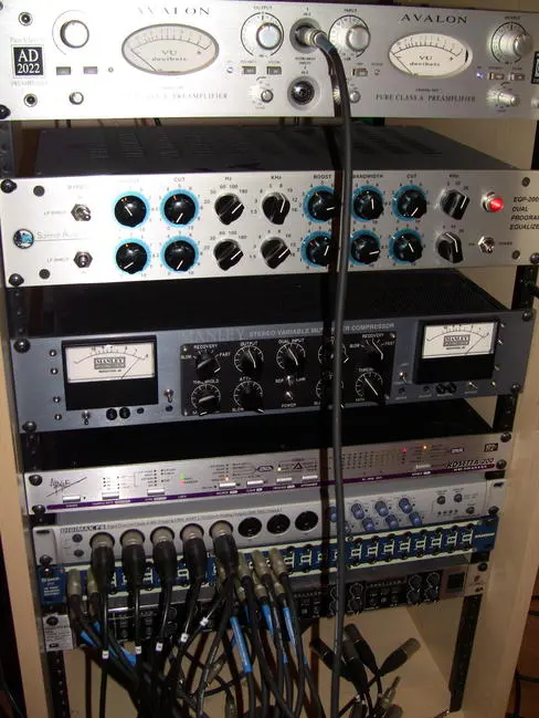

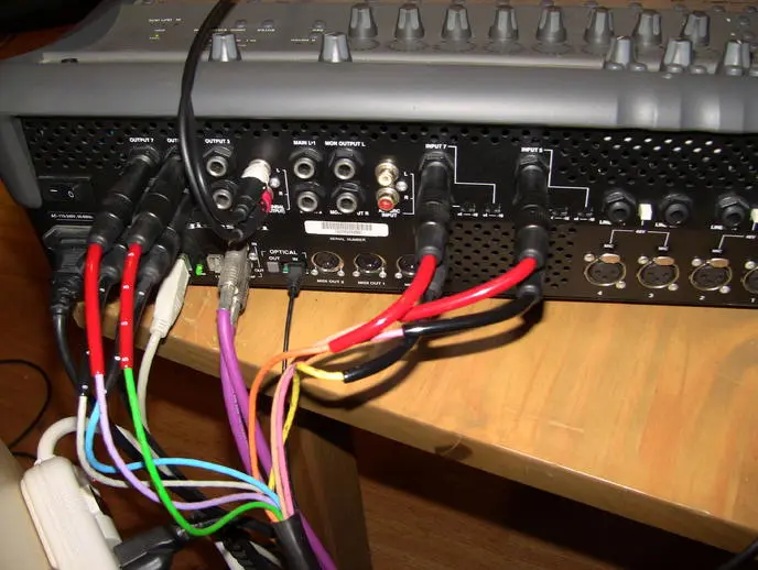

Here are some pics of my setup. The first pic shows me going directly into my Avalon preamp. A few racks down you could see a Rosetta 200 a A/D converter. Could the Rosetta be my possible link between the Series 70 and the Digi002? The other 2 pics are the back of my Digi and the back of the Series 70 with the RCA connections.

Look at the picture...your reel is not mounted evenly...that's why your tape is rubbing the flange.
Hey...you have some nice rack pieces. :cool:
How do you like the Manley comp?
Miroslov, sorry that pic was when I had removed the set screw on that top piece and although it is a little straighter than the pic depicts, the tape is still rubbing. What is odd is that there are 3 tabs on the screw down piece that fit into the 3 tabs on the reel, so you would think that it is forced to be centered every time you screw that top piece down. I've tried everything with no luck.
As for the Manley, yes I love it. It is the best sounding compressor that I ever heard, so I am big fan. I checked out your studio page, very very nice. I liked your guitar vids too. Nothing like a little recording sanctuary, in house.
those hubs are not fun to use. That said, you may need a reel table adjustment. My deck needed that too...
