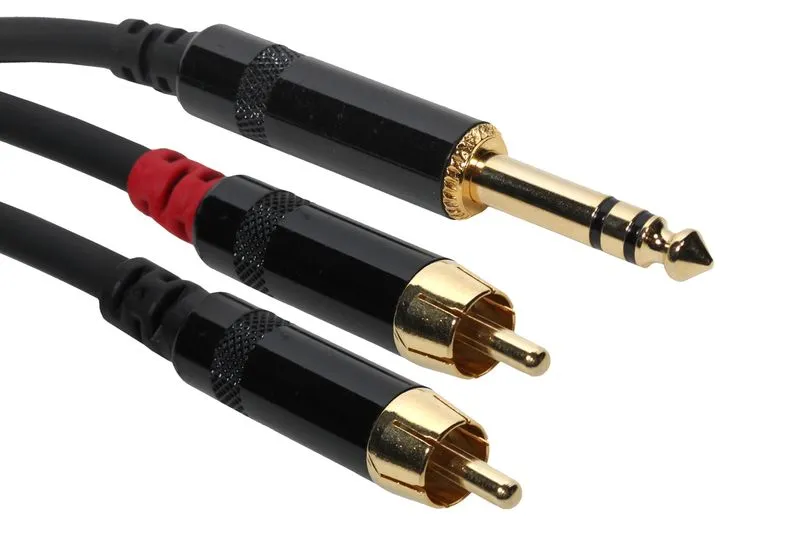

Something like this:
After you get yourself this cable, just connect it from your Berhinger's RCA outputs into one of the 2i2's inputs and you're good to go. Make sure to select "line" right under the 2i2's input jack.

I'm not really sure how this cable is going to work. Going out of the mixer L/R (stereo) and going into just one of the mono TRS jacks of the 2i2, the L/R signal would show up on the TRS on the tip and ring and the result would not be a L/R stereo image from the 2i2 into the DAW (at least I don't see how it's possible).
Two RCA's to 1/4" TS phone plug cables to each line input on the 2i2 would seem to me the way to go. The L/R signal could then be assigned appropriately L/R in the DAW.
Hey Mark,
This is a stereo RCA to stereo/balanced TRS cable.
The 2i2's input jacks, as far as I know, are compatible with stereo/balanced TRS jacks and stereo instruments like keyboards. They're hybrid jacks (XLR/TRS balanced/stereo or unbalanced/mono).
I own a Scarlett 2i2 myself but never tested it using stereo instruments. Theoretically, it should work, though.

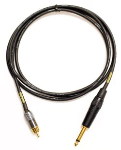

The 2i2 are combo jacks for XLR, 1/4" bal/unbal, but not for stereo. Your suggestion is close, but the op would need 2 RCA to TS 1/4" cables.
Yep. My bad here. You're right, Chili.
Just checked out it's ASIO configuration and both inputs are just mono indeed.
So, the solution would be to use two single RCA/TRS mono cables, each one connected to a line input on the 2i2, then combine both mono signals as a stereo track inside the DAW, right?
