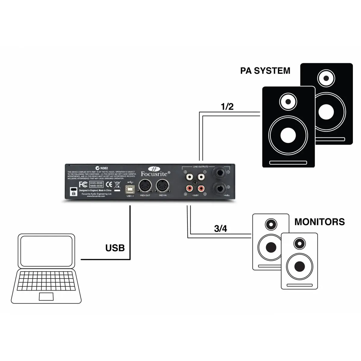

A ALopes819 New member Apr 1, 2013 #21 jimmys69 said: Line outputs 1/2 should be the default monitor outputs from the Focusrite. Not 3/4. You would have to select 3/4 from within a DAW. Click to expand... OMG THANK YOU !!! IT WORKED !! Idk why but on the diagram it shows the following :/ THANK YOU ! YOU'RE THE MAN ! *Adds Rep*
jimmys69 MOODerator Apr 1, 2013 #22 YAY!!! Yeah, the drawing is a bit misleading. Glad you are up and running.
S Stefan A New member Apr 2, 2013 #23 Yeah, the drawings were unclear. Guess that's the difference between logic and experience. Glad it's working now.
