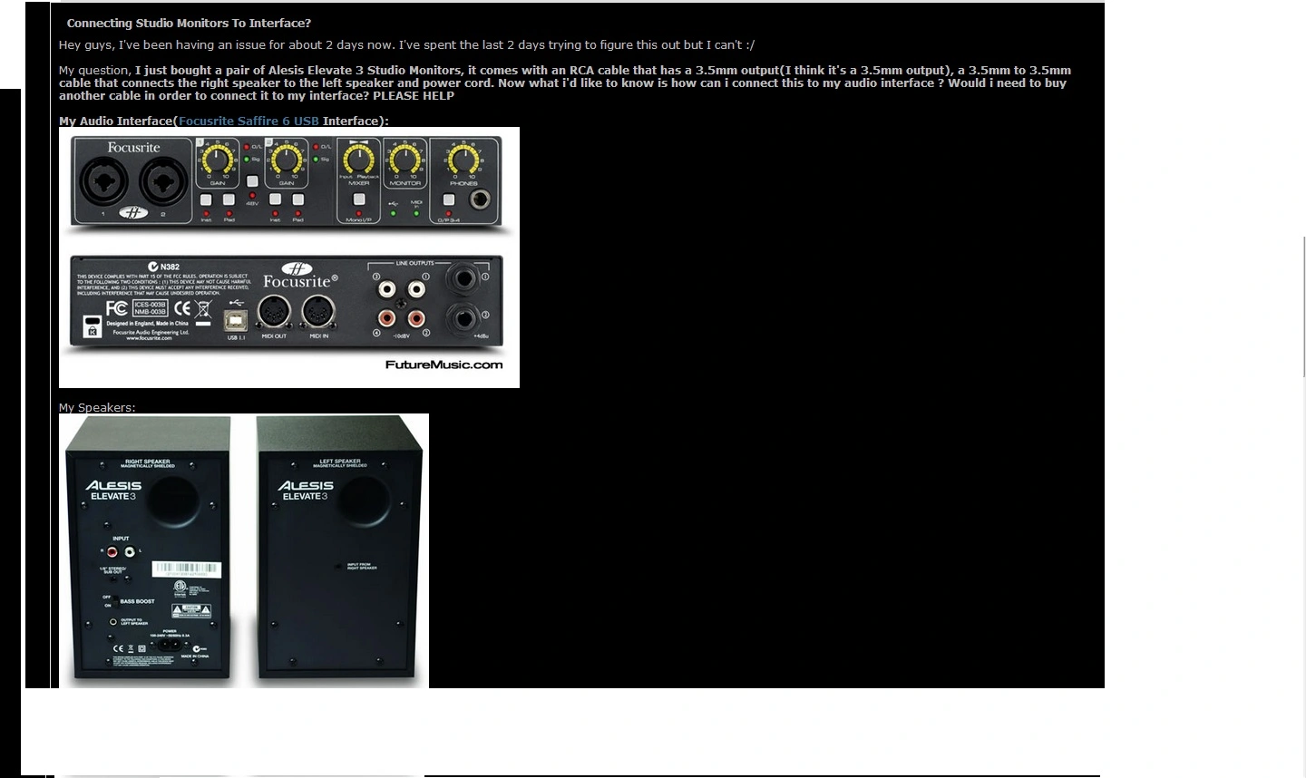

Hey guys, I've been having an issue for about 2 days now. I've spent the last 2 days trying to figure this out but I can't :/
My question, I just bought a pair of Alesis Elevate 3 Studio Monitors, it comes with an RCA cable that has a 3.5mm output(I think it's a 3.5mm output), a 3.5mm to 3.5mm cable that connects the right speaker to the left speaker and power cord. Now what i'd like to know is how can i connect this to my audio interface ? Would i need to buy another cable in order to connect it to my interface? ALSO, There's a 1/8'' Stereo/Sub out, do i need that ? what is it used for ?
My Audio Interface(Focusrite Saffire 6 USB Interface):

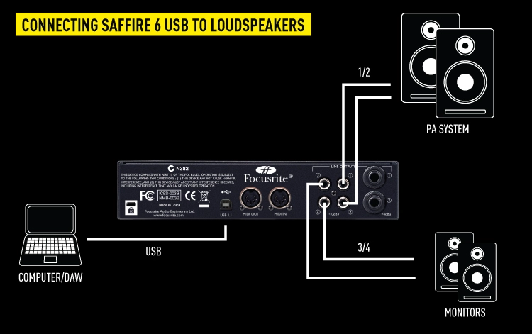

There's a diagram that shows where the monitors connect to, it's just that I don't know which cables i'll need, and how to connect it to my interface, RCA to RCA isn't recommended is it ?

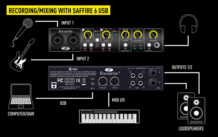

Here's another diagram that shows the speaker input to the interface in a different location ?
thanks for the help in advance !

Looks like you can do RCA if that is what you have at both ends.
I connect a 1/4" adapter to a pair of low impedance lines,
run them to my amp and convert to RCA there.

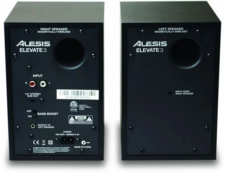

here's the back of my studio monitors
You lost me there man, still new to all this stuff :/

The front has an input for headphones, and volume/power knob. Also, I have a subwoofer(small one that came with speakers i bought a while ago, the output for that is a 3.5mm and it fits perfectly into the 1/8'' stereo/subout, i can keep it in there right ? &| Ok i'll try using some RCA cables i have laying around and see if that works, i'll let you know in a few man, thanks !

Also, the monitors came with RCA to 3.5mm, is it required that i use the 3.5mm as an output or something ? :/

it comes with a quickstart guide, in which i've already read, doesn't seem to be much help. It does say that the "STEREO/SUB OUT" = "This is a full range audio output which can be connected to a mixer, powered speakers, or an external recording device."

Line outputs 1/2 should be the default monitor outputs from the Focusrite. Not 3/4. You would have to select 3/4 from within a DAW.
