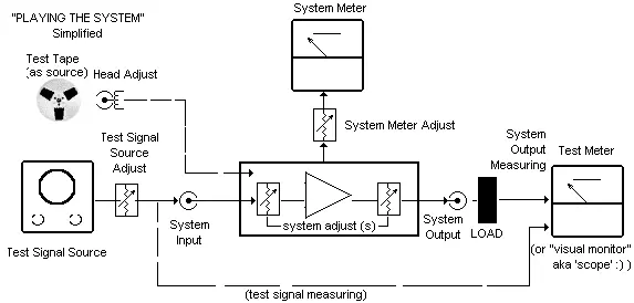

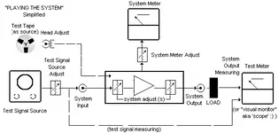

See the attached pic.
You see, you can "Play The System" to your own desire or to your own "standard" (within the limits of the system of course). You sure can match (make uniformed :) ) the systems within the "multi-system" - muti-track machine that is. etc.
If you wish to tweak your system so it corresponds (or "perfectly" complies) with an established and "universally accepted" remote system (a standrad), then it (the task) gets more demanding. Then you have to follow the exact procedure as described by the maker of that system and you have to use the Test Signal Source and the Test Meter (Measuring Device/Monitor) which themselves comply with a "remote system's" standard. Actually a standardized Test Meter can evaluate (or say verify) the Signal Source and if the source is adjustable, then it can be "standardized" right there on the spot, however it does not apply to the situation, where a pre-recorded tape is The damn Source.
Some people refer to those "Sources" and "Measuring Devices" as "Trusty"...heh heh
Compliance grants The Trust, that is :p , and Don't we all see how it "works" all around us :rolleyes:
A side thought: If your system seeks no direct / indirect interaction with other (remote) system(s) (Systems that were/are being Played by others, that is ;) ), then it's free as a bird :D

here's the pic
:D
