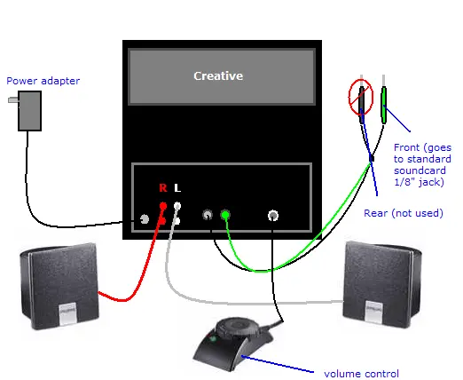

Also, I thought I'd attach a picture of what the subwoofer looks like on the back and how the speakers hook up and everything.
Hopefully it makes sense.
Thanks again.
The green cable in your picture -- is it hardwired into the subwoofer, or does it have a plug that connects to a jack on the subwoofer? If it has a plug, it will be easier to find a cable to connect to it.
It's not hardwired. I can plug/unplug it. :)

Grilled_Cheese said:
Could you possibly draw a quick little picture showing what kind of cable I would need?
So, it's not hardwired. In other words, the green cable has a 1/8" stereo plug on each end, right?
If you want to use the MONITOR/THRU jacks on the headphone amp, you'll need a cable with two 1/4" phone plugs on one end, and a 1/8" stereo plug on the other end. Here's one: http://www.zzounds.com/a--2676837/item--HOSCMP15.
If you just want to connect a headphone output to the speakers, use an adapter with a 1/4" stereo plug and a 1/8" stereo jack (e.g., http://www.zzounds.com/a--2676837/item--HOSGPM103). Connect the green cable to that adapter and plug the 1/4" plug into one of the headphone outputs.
That's correct. One green end on each side of the cable (which is a stereo 1/8" like headphones).
