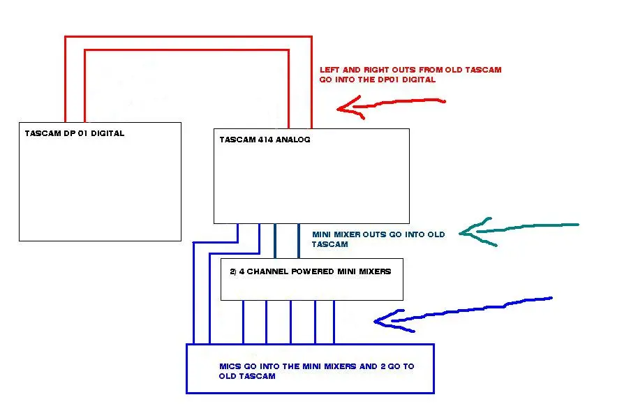

Below is my recording layout. I would like to add some compression and gating to my signal.
1) Can I use "stomp box" individual guitar pedals for this? (I've found single pedals as compressors and gates)
2) Where in the setup should I plug them? (see the color coded arrows)
Give me a hand guys.
All your input is greatly appreciated.
Cheers!

My first question is which signal do you wish to apply the compgate to? The answer to that should narrow down where they would go. If you're looking to process just one instrument/line, then you'd want to do that before the lines get mixed/submixed. If you wanted to process the whole submix, then you'd want to put the processors after the mixing.
Stomp boxes can sometimes work, but not always. And when they do work, they are not ideal.
First, they are not the cleanest devices in the world, by a long shot, they'll add noise and distortion to your signal. If you want that 'stomp box sound' like that, then fine. But if you're looking for clean processing, they are not the best way to do.
Second, it depends upon the in/out specs of the box and on where in the signal path you wish to put it. Nost stomp boxes are designed to handle instrument-level signals (pre-mixer, pre-preamp). If you want to apply your processing on the line-level signals coming out of the mixers, a stomp box is not really the right device to use there.

I should've said that this setup is used to record drums. I use the 7 signals (kick, snare, hats, 3 toms and one overhead), so I would like all the mics to be processed. I guess, after your answer, I can:
a)get an 8 input/8 output compressor/gate and plug all the mics before getting mixed or
b)get a 2 input/2 output compressor/gate and plug the Tascam's 414 L & R line outs to the processor, and then to the DP01.
Which of these two setups do you recommend, A or B?
Do you recommend processing all of the drums mics, or just some of them?

The question about wheither to proccess all or just one indicated you don't really know what your doing with the compressor. Might sound harsh, but it might be smarter to figure out if you really need compression and gating. There are plenty of great drum tracks out there that are completely void of compression or gating. Then again, many are compressed and gated to some extend. That's a while education on it's own.
As far as the signal chain is concerned, getting 2 channel compgate and putting that on the main bus will compress everything, which might be what you want, but I doubt it.
An 8 channel compgate (or more likely multiple units) will help in that case, but it's gonna cost you. Use them as inserts if you go this way.
Do NOT go the stompbox route, belief me. Stompboxes are guitar tools, and that's pretty much what they are good at, and not much more. I could explain this, but it would be a loooooooong post ;)

Thanks Halion for your time answering. It really helps me understand better. One thing that is very clear now is that compression and gating should be done to individual channels. As you said, comp/gating the whole mix would be a huge mistake.
I gave it a shot last night, recording and using my stomp box compressor, and the results were awful. I just tried with my snare.
I record just for pleasure. I don't make a living out of music. All the gear I have been buying since long ago is just to have my peace of mind. I wanted to "cheaply" raise the quality of my songs, but I see there's no shortcut here, for a quality recording you need pro gear. Compressors and gates for 8 mics is a pretty expensive setup, and as you said, maybe and most probably, I don't need them.
Don't worry, this won't dissapoint me at all, on the contrary, it will help develop my recording skills without any processing, as to get the most "near" perfect clean track, so I can maybe start learning to use a PC based editing software.
