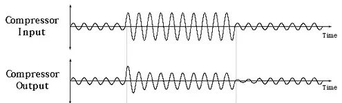

What about frequency response?
Glenn:
What happens to the frequencies? Let's say I start with a sound wave, Picture 1. Then I compress the sound wave, and it becomes Picture 2. This is how I've always thought of compression, but as it applies to the dynamic range of the sound wave...
When I'm applying compression, I understand what you're saying about my tonal balance changing, because I'm now blending 100% of my low-energy sound with a smaller percentage of my high-energy sound, but how does this apply to the frequencies of the sound wave? Would it mean that I am compressing more of the low-frequency end of the spectrum, since low frequencies carry more energy? That would tell me that I should end up with a brighter sound, but that's not what actually happens...
Are the dynamics of the sound wave so much more prominent that I just don't notice how the frequency balance is changing - i.e. it's so subtle that I notice the dynamic change over the tonal change?

I'm sure Glen is typing a much better answer, but here goes - any instrument makes a sound by producing a fundamental frequency and many "harmonics" of that frequency. Their relative balances make up the "sound". So, each of these frequencies have an associated amount of energy to them. A compressor will squash the higher energy ones, bringing out the lower energy harmonics. Thus, altering the "tonality" of the instrument.

NL5 provided a key clue when he referred to harmonics, which will be a major (but not the only) source of lower-energy frequencies.
Your diagrams are perhaps just a bit - unintentionally - misleading because they are showing what I assume is intended to be a sine wave of a specific frequency. Applicable, perhaps, to an analog synth voicing a single oscillator or some other instrument that is a source of a pure tone. Even then, a real-world sine wave is really just a collection of harmonic frequencies summed together into a "larger" sine wave.
But for a maybe easier to visualize - ane more real world - example: For most instruments, the waveform will be much more complex. What peeks/peaks above the threshold may be lower-frequency stuff, but it can also include high-frequency transients, not to mention higher frequency elements that are in effect modulating the lower frequency carrier. Also there can be low frequency "mud" and subharmonics and so forth that are lower in overall volume than the "main" forments. All in all, it can be a real mish mosh.
If you were to take a signal (even your sine wave) and slice it into 2 or 3 or 4 horizontal volume range slices, and take a spectrogram or FFT analysis of each slice, you'd find each has it's own spectral distribution or fingerprint. So it naturally follows that if you change the relative volumes of these "zones" you are going to be changing the composite spectral fingerprint of the overall signal.
I think we've all experienced a situation where something sounded "good" - say a 2mix buss, for example - but when we needed to reign in it's dynamics a bit with a compressor what came out the other end sounded honk-ish or harsh or some other unpleasant adjective, because we inadvertantly adjusted the tonal balance to unintentionally emphasize some of the more unpleasant formants that were at relative low levels before we compressed. This has nothing to do with the "coloration" of the compressor itself, but rather just that the act of compression itself exposed the previously low-level some blemishes in the sound.
EDIT: NL5, my answer (as usual) was only longer. Yours was better :) - G.
G.
Bad example. I drew that quickly just to show the effect of the compressor clamping on the peak at the top of the wave that passed the theoretical threshold. :D
I think I grasp what you're saying, however. That the compressor may be clamping down on the most energetic portion of the dynamic curve and leaving the harmonic "artifacts" that came along for the ride unaffected. If I'm off base, let me know.

Well, yes and no on both counts. You're saying the right thing, if I read you right, but the above statement is a bit contradictory.
Sure, the fundamental frequency of the sine remains the same, but the harmonic content does change. As you say later, the two different versions of the sine do sound different in the same way as a sine wave and a triangle wave of the same frequency will sound different, even if they are of the same peak amplitude (though the triangle will sound more different, of course.)
They sound different because the amplitudes of the constituent harmonic frequencies change. This is what changes the "tone" of the signal between the two different wave shapes. If you take a spectral analysis of the two different sides of your graph, they will indeed look different as well as sound different, even if you were to even out the gain at output, because even though the fundamental frequency and peak amplitude of the wave is not changing, the harmonic content is.
Now, this is all whiteboard stuff. XLR does imply a good point in that just how *audible* these changes may or may not be depends greatly upon all the factors listed. if you have a high threshold with a soft knee just to smooth some wild transients, for example, the actual audibility of tonal change will probably be questionable, and probably masked by the distortion introduced by the "color" of the cpmpressor itself.
However, the strict OP question of whether compression changes the tonal balance of an instrument, has a strict and definitive answer of "yes, it does", regardless of any further coloration.

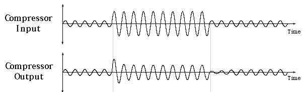

OK, more graphs! (below). In the input signal, I have big dynamic range that is full of my dominant frequency, right? And somewhere below that I have all my harmonic frequencies. Then I clamp on a compressor, and the signal changes to "compressor output". My dynamic range is reduced, and I'm going to end up amplifying the signal. As I think I understand it now, the harmonic frequencies that were once buried are now right up there with my somewhat flattened dominant frequencies. The frequencies haven't changed, but the balance between dominant and harmonic has changed. Am I on the right track?

If I'm understanding Glenn and NL5's discourse, then that's technically correct, but in a practical sense the harmonic frequencies will end up amplified.
These are the best pics so far that show the action of the compressor. Some people think that the compressor acts on each wave distorting it but that only happens on bass instruments if the attack and release are too fast. A compressor/limiter is a voltage controlled amplifier and the control voltage tracks the peak voltages. Some compressors let you select the RMS (average) signal level instead of the peaks.
Your illustration shows the first cycle getting through so this compressor is either a little bit slow reacting or the attack control has been set to let the leading edge through - that's good for emphasizing transients. In fact that is one way that compressors affect the perceived tone of the sound - attenuated transients make the sound less bright and accentuated transients make the sound brighter.
