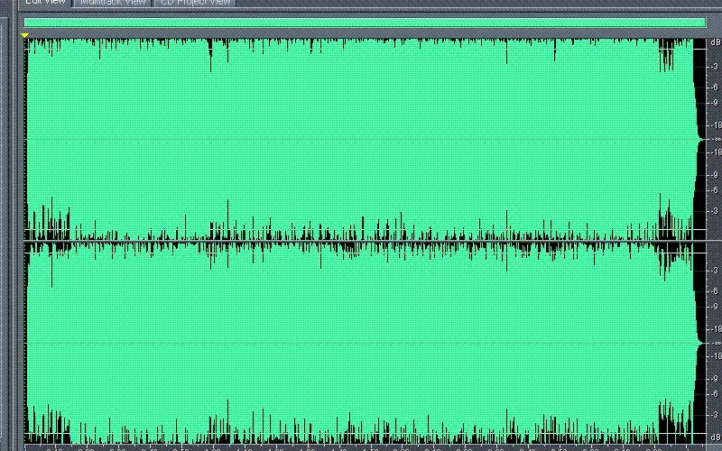

Hello, I have a question about compressing the "final mix". When I compress my song, it ends up looking like this...
***(Please See mywave.gif)

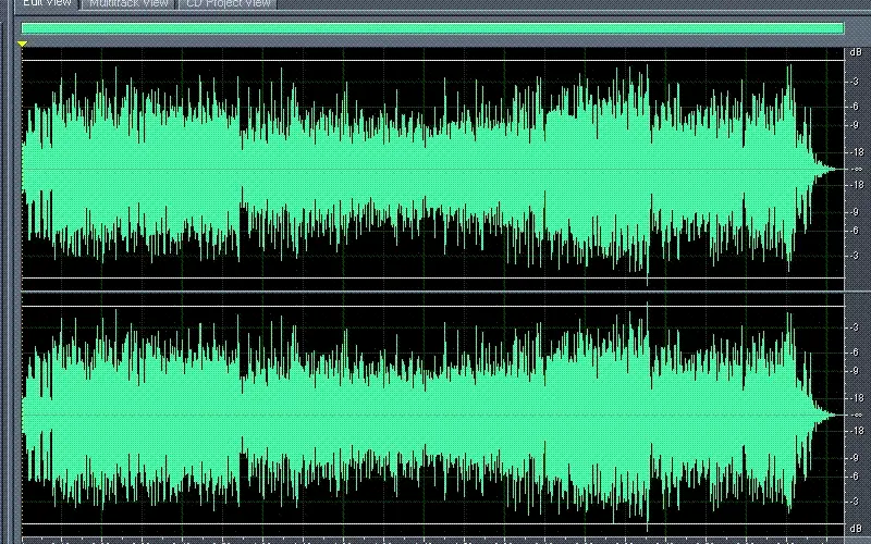

When studios compress songs, they look like/or similar to this...
***(Please See studiowave.gif)

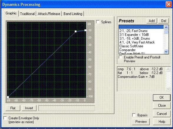

The preset I use to get my songs to what they look/sound like, I use this (B.T.W., I use Audition a.k.a. Cool Edit)
***(Please See graph.gif)
How do I configure the Dynamic Processing settings, so that my songs will not only look, but sound like real studio's mixes (No clipping too, obviously)? How much has to do with the level of the vocals and the doubles and the instrumental, etc... during the mixing stage?

Put a limiter on it and crank it up if you want the wave.
Send it to get mastered (just the way you've got it now) if you want the sound (if it sounds good to begain with that is).

I'm trying to do the best I can at my house. But, the way pro studios do it, you get the sound and the waveform look. (I'm just trying to compare the 2 by the waveform, because I know if I get my waveform to look almost like the studio waveform, they will most likely sound the same. Right?)
lowlow42 said:
Makes sense...
Wrong.
Try it, and you'll hear what I'm talking about. Trying to emulate frequency curves from other recordings is another mistake some folks make, and will not make recordings sound the same. They may be a little closer in the ballpark, but there are too many variables to try to sculpture audio by visuals. Even if two tracks show the same RMS level, one may sound louder than the other.

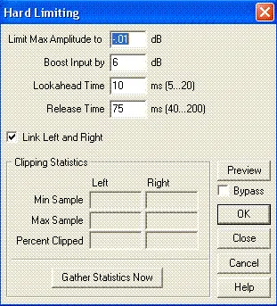

Well I played with the "Hard Limiting" feature, and I think I may have stumbled upon my solution...
I got the nice rich mix, and the waveform looked similar to pro studio waveforms... and thats all I really wanted.
Please see picture, are those settings safe/fine?
giraffe said:
i think i'd try a faster release time.

Hard limiting is one of the elements, but not the complete story. Hard limiting is used for keeping stray transients down so that you can raise the overall level. Compression is used for adding "fullness" or density. It's the combination of the two that you want to use in most cases. I would also lower the maximum amplitude to -.5 db to help insure that it won't distort on some D/A converters.

Read... Lots... Don't EVER judge a mix by "what it looks like" as opposed to what it sounds like.
Personally, the "studio" wave "looks" like it would sound like clipped sh*t.
Believe it or not, before 1990 almost no one knew what their song looked like. They had to concentrate on what it sounded like. Stop looking at your music and start listening to it.
