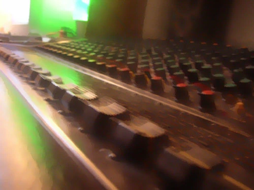

Attached, is a picture of my board...not the greatest for showing the whole sucker, but it was a cool shot.
It's an "AudioPro 16-S". Yorkville used to make them in the 80s. For a 16 channel board it's quite large compared to how small they make them today. I bought it from my "step-cousin" about 2 years ago, where he had got it from some other guy he knew. It's a nice board, besides how freaking dirty it is. I think it was meant to be more a live sound board, it has 2 channels for effect inputs, monitor channels, sub channels and a main channel. It'd be cooler if it had a metre bridge, yeah...heh.
