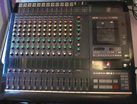

Okay, . .So, I went out to OfficeDepot yesterday, and got myself a cute little mini-vacuum cleaner, designed to lift the dust from the crevices of computer casings, and keyboards. . .I thought it would be a great tool for cleaning the surface of my dusty mixer, getting inside all those hard to reach areas. . However, its an electric mini vacuum. .NOT Battery powered.
So, now I'm thinkin' (can ya smell it?) Will the electric powered mini vacuum produce too much static electricity to mess up the electronics inside of a mixing board, or recorder????, . . .compared to say a battery powered vacuum. . .
Granted the battery powered mini-vacuums do not suck as well as the mini-electric ones. .But, will I be safer with a battery powered one . . .?
I wasn't planning on using it inside the mixer, just on the surface. . .what are your thoughts. . .
I don't foresee a problem with using an AC powered vacuum cleaner around a mixer but just keep it away from any tapes or heads because of the magnetic field that may or may not emanate from the motor. The mixer itself shouldn't be adversely affected by it.
Cheers! :)
Thanks Jeff, . .
Initially, I didn't think there should be a problem with using the electric computer-vac either, http://www.officedepot.com/ddSKU.do?level=SK&id=402741&&An=text
. . .as long as I only used it on the surface. But, the dusty mixer in question, is attached to a cassette tape recorder the Akai MG1212 (sorry, I should have mentioned that initially). . . and I'm wondering by using the electric vacuum on the surface area, . .will the motors magnetic field start messin with the tape heads. . . or am I just bein' too fricken paranoid. ;)
Considering the unit in question, I would 86 the vacuum all together then.
Take the unit outside with the bottom cover off and blow it out with compressed air from a can or from a compressor if you have one.
Cheers! :)
I'd definately lean towards using a compressor to blow rather than a vacuum cleaner to suck - we have a compressor at work that the techs use to blow dust out of old PCs, far fewer potential issues than a vacuum cleaner.
