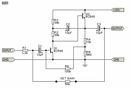

You can Probably build a cheap Pre useing a few Transistors, resistors and caps or just use an Opamp....You could probably do it for under $20 and your Time.....
Just a Thought if you are electricly inclined.....

This circuit here can be built for probably $2 (Minus connectors ,PSU ,Chassis ect) and actually sound pretty good and has pretty low noise, I have another that is only slightly more complex and has Ballanced in/Outs but only about 35db gain but it can be boosted with use of a dual opamp.....
