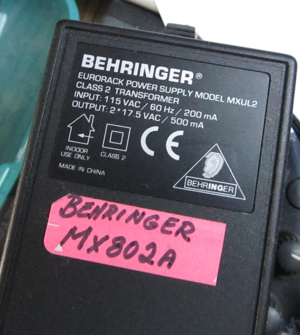

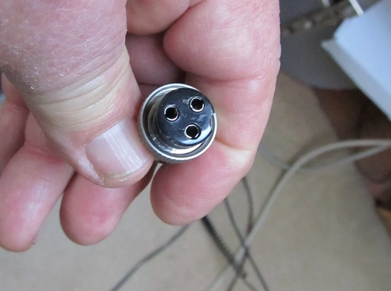

The MXUL2 puts out two voltages of 17.5vac with a center tap to a 3 pin connector which is retained to the mixer with a threaded ring, so not a PS that can easily be substituted.
herbgarden, on the Chinese knockoff, what is the ma (milliamp) rating number after the OUTPUT: 2*17.5VAC / ???ma ? This is an important number, as if it is too small, the PS won't be able to provide adequate power to the mixer. Do you have a link for the ebay knockoff or did you already buy and could post a pic off it?

Edit......... Are you sure it's the PS that's bad and not the mixer? Checked the end of the PS connector with a meter set to AC volts? If needed I can check mine and let you know which pins have voltage on them.
Is this the one from ebay....... 17V 600mA Mixing Console Mixer Power Supply AC Adapter 110V Input F1B2 730060597171 | eBay ?
