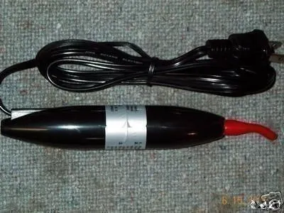

Thanks Reel. That's actually the price I paid. I found that on ebay after searching more as you suggested. It come out to about $21 including shipping.
I just didn't bother to use that exact link for my last question because it was related to how to use the tool, not the cost.
I'm still worried about...
cjacek said:
Btw, do not demag UNLESS you know precisely what you're doing or you may damage the heads.
Can somebody tell me how exactly to use the darn thing?
Thanks
Simply Bass,
A Reel Person & cjacek will tell you & they're TOTALLY RIGHT that the demagnetiser is great but dangerous.
REEL has already talked about distances & media etc. Follow those instructions carefully.
You also have to ensure that the demag wand DOES NOT TOUCH THE HEADS.
This can be achieved with a VERY careful hand but also, at a pinch, by using something on the end of the wand tip to prevent accidental disasters. Mine came with a soft plastic tip cover.
The other fellows will give you better guidance.
I'm stoked that you didn't buy one of the cassette case based demags. they are cute BUT the actually bring the head & demag into contact & that's BAD.

*The recorder should be off!
The dmag wand should be turned on well away from the recorder and any media. Then bring it in slowly to the tape compartment and wave it around, back & forth & in random patters around the heads and metal tape guides/capstan. That type of wand has a plastic tip, apparently, so I think you could touch the head & metal parts with no problem, but always keep the demag waving around randomly, slowly but deliberately, and never have the wand sitting anywhere staionary near the heads. It loads up the current, so a good idea is 30 sec. on & 30 sec. off, as long as you slowly bring the wand away from the recorder when switching on/off. If there's directions with the wand, read them and follow them accordingly.
