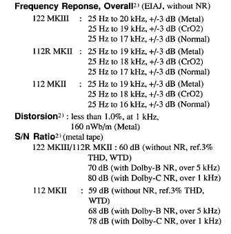

what about low frequency range?
Here are some specs from Tascam 122/122 decks. It varys a little between manufacturers though.
Great service for guys who can't click-a-link. :) God knows... you may even get a thank you for it. ;)
