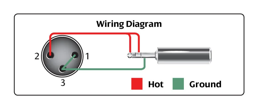

I'm guessing the cable you have (XLR to 3.5mm) is not properly wired to take the 'balanced' mic connection and convert it to an 'unbalanced' connection the PC is looking for.
Secondly.... is this a PC desktop type computer or laptop? Newer laptops sometimes have combo jacks that take a different plug for a headset/mic and a bit more of a challenge to make work.
A cable I have that works is a HOSA XVM-110F . This cable bridges pin 1 & 3 of the XLR together to the sleeve of the 3.5mm plug and leaves pin 2 'hot' to the tip and ring of the 3.5mm plug, diagram below. I had bought this cable to be able to use XLR connected mics with a camcorder, but seems to work fine with my PC. I attached a short mp3 using an AT2020 to a Behringer PS400 phantom supply through an XVM-115 cable to the PC mic jack recorded with Audacity.
If the XLR to 3.5mm cable you have is not wired like the diagram you might be able to 'mod' it if you're handy with a soldering iron.

Like arcaxis says, maybe. I'd say it's probable that you can pass signal, but it's not what pro mics with balanced output are designed for. The 3.5mm input on a computer is meant for unbalanced input, and it likely provides "plug-in power" to the mic. If it happens to have a three contact connector they are doing different things than the three pins of an XLR. You'll have to translate between the two, which is what arcaxis' diagram shows. Most likely it will work but a proper audio interface would be better because it is specifically designed to connect a balanced mic with XLR output to a computer and also provide low latency monitoring of that input.

I would not modify the XLR to 3.5mm because again, as stated, there is power present on that jack. Probably too feeble to do any harm but the audio results will be poor anyway.
However, if you are of a practical bent and can solder, you could buy an audio transformer which would both isolate the mic/phantom supply from the PC and deliver a balanced input.

This is very common and the real problem comes down to the balanced to unbalanced conversion. The 48v phantom is applied between the balanced conductors to the mic and ground. In the unbalancing, one of these is shorted to ground. Most phantom units use two capacitors to prevent the DC running back to the audio input, acting as isolators but the unbalancing can reduce the supply voltage and shift it away from the centre with the upshot that sometimes there will be 48v but very little available current. 3.5mm inputs are simply not designed for quality microphones! Even if electrically they work, they have worse audio performance than is acceptable, frequently requiring high input levels as their available gain is mediocre.

As I say, worth looking at if only to eliminate those possible errors. I'm with the others who think it's likely the wiring in the XLR-3.5mm cable. This gets even more complex because there's no real standard for input jacks on computers. Some are wired for stereo feeds, some for mono and some even have an extra ring to allow headphones with built in mics.
