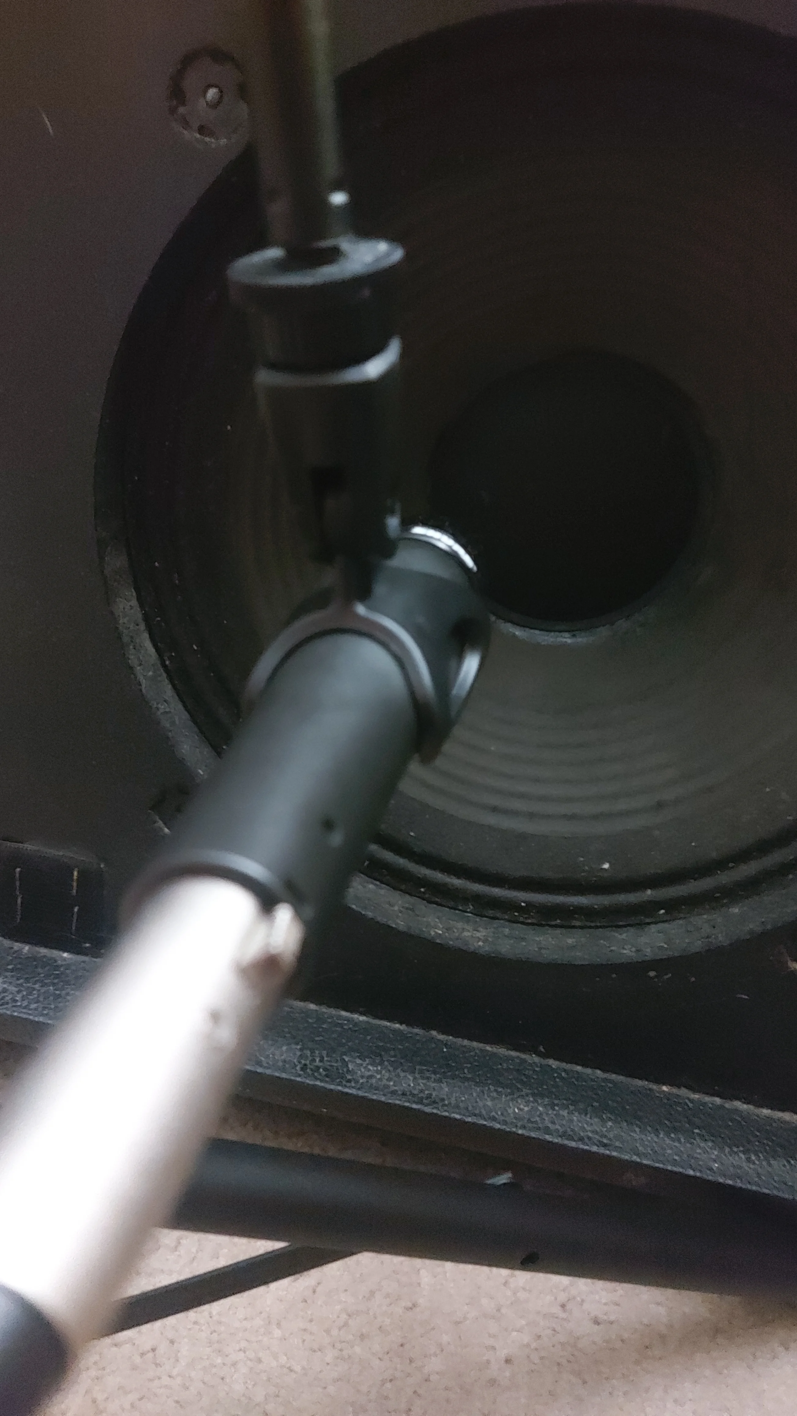

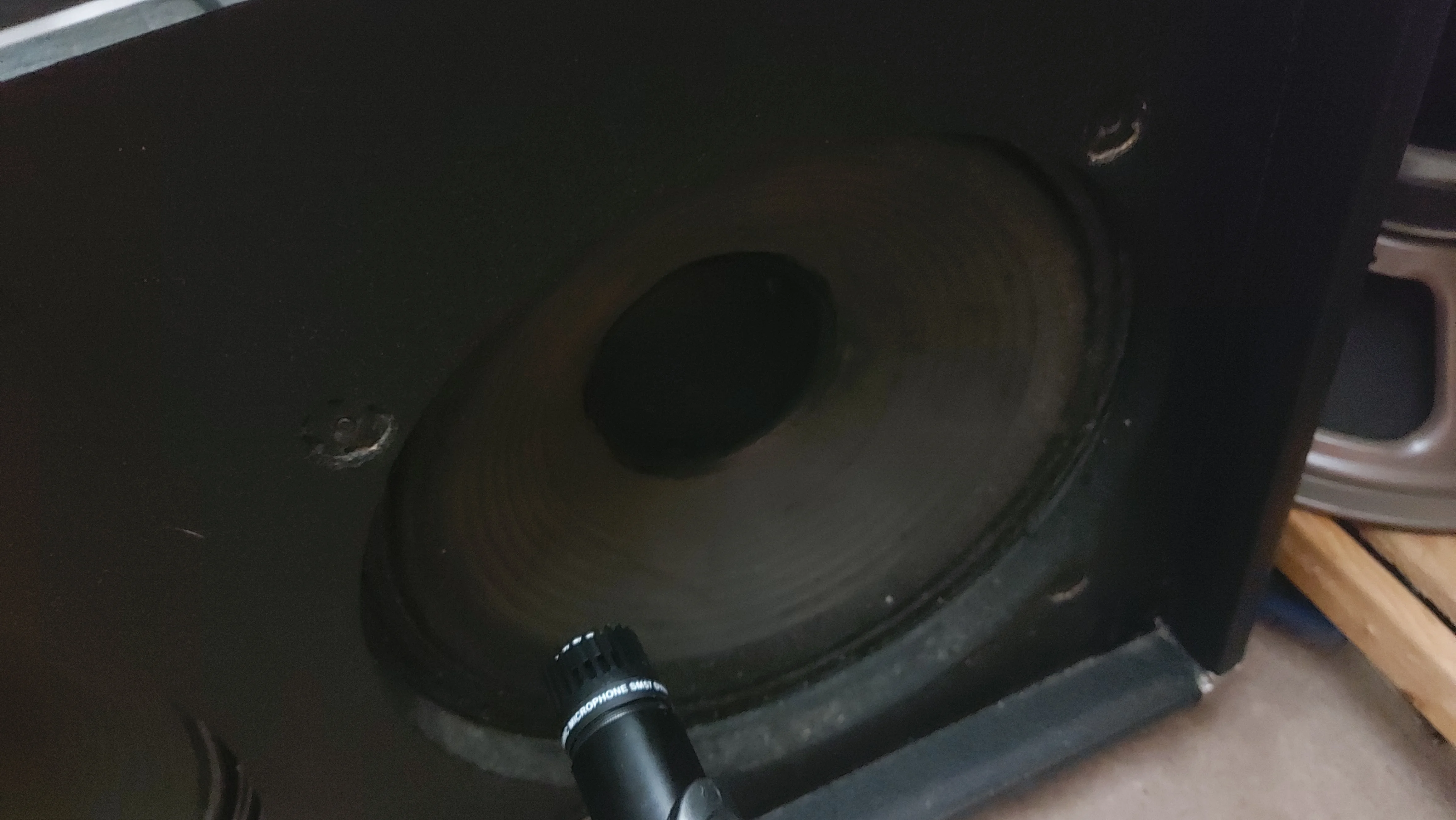

So i recorded it using the Scarlett solo. I recorded it in a hurry so i just used the shure xlr to xlr cable into the xlr>line for mic 2. I know that wasn't the best but i hooked it up that way just so its recording at the same time. So the one input has the xlr and the other one was the line input. I do plan to do some recording tonight recording one at a time into the xlr port. I guess i could also use my looper pedal. (Record a whole riff/song using it then change mic postion and playback with another microphone postion.) Wouldn't be most efficient way of recording multiple microphone postions though with 1 xlr port.
If you have 1 microphone where is usually the most efficient microphone placement? I heard outside dust cap or middle. And touching the grill cloth or almost touching. With the sm57
Thanks for your help guys i have been having lots of internet troubles with my router so i haven't had my computer to type more detailed longer messages.
I'm hoping that the first file is in the second input as it sound weak. The one by the dust cap sounds pretty much normal, especially the "clean" section.
I'm curious how you are getting your distortion. It is horribly shrill, there's no bottom at all to it. What's your amp and distortion pedal setup.

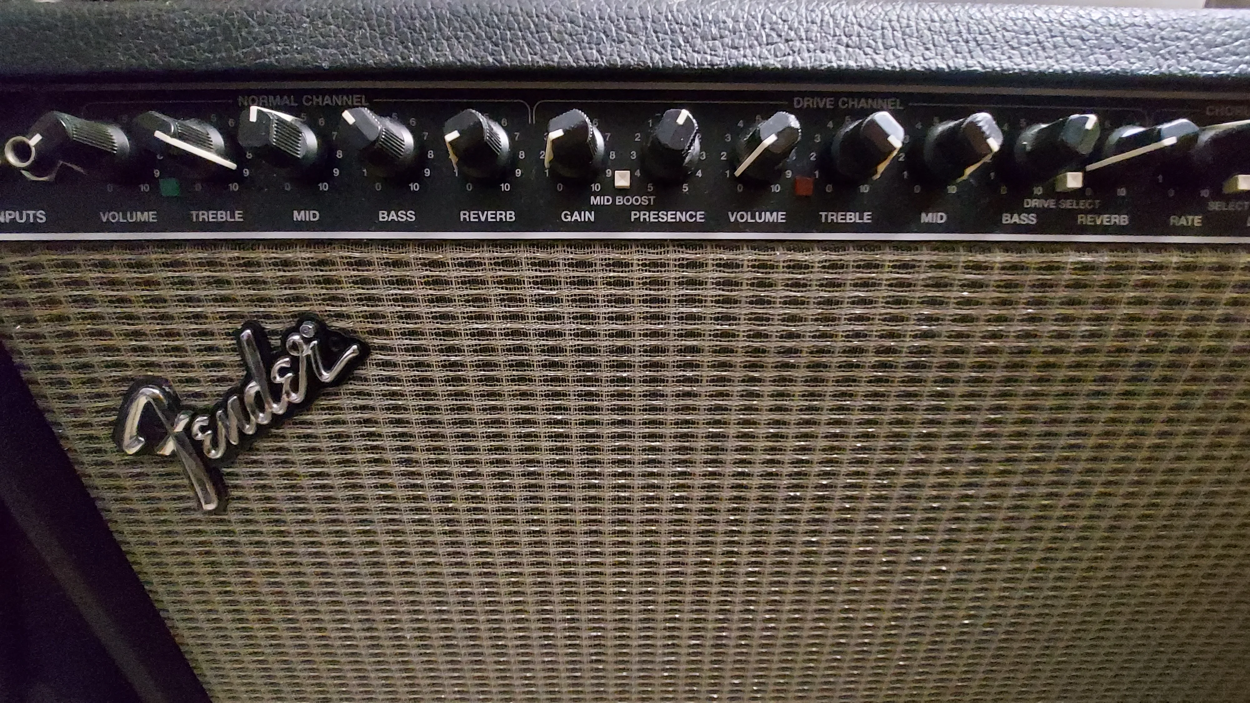

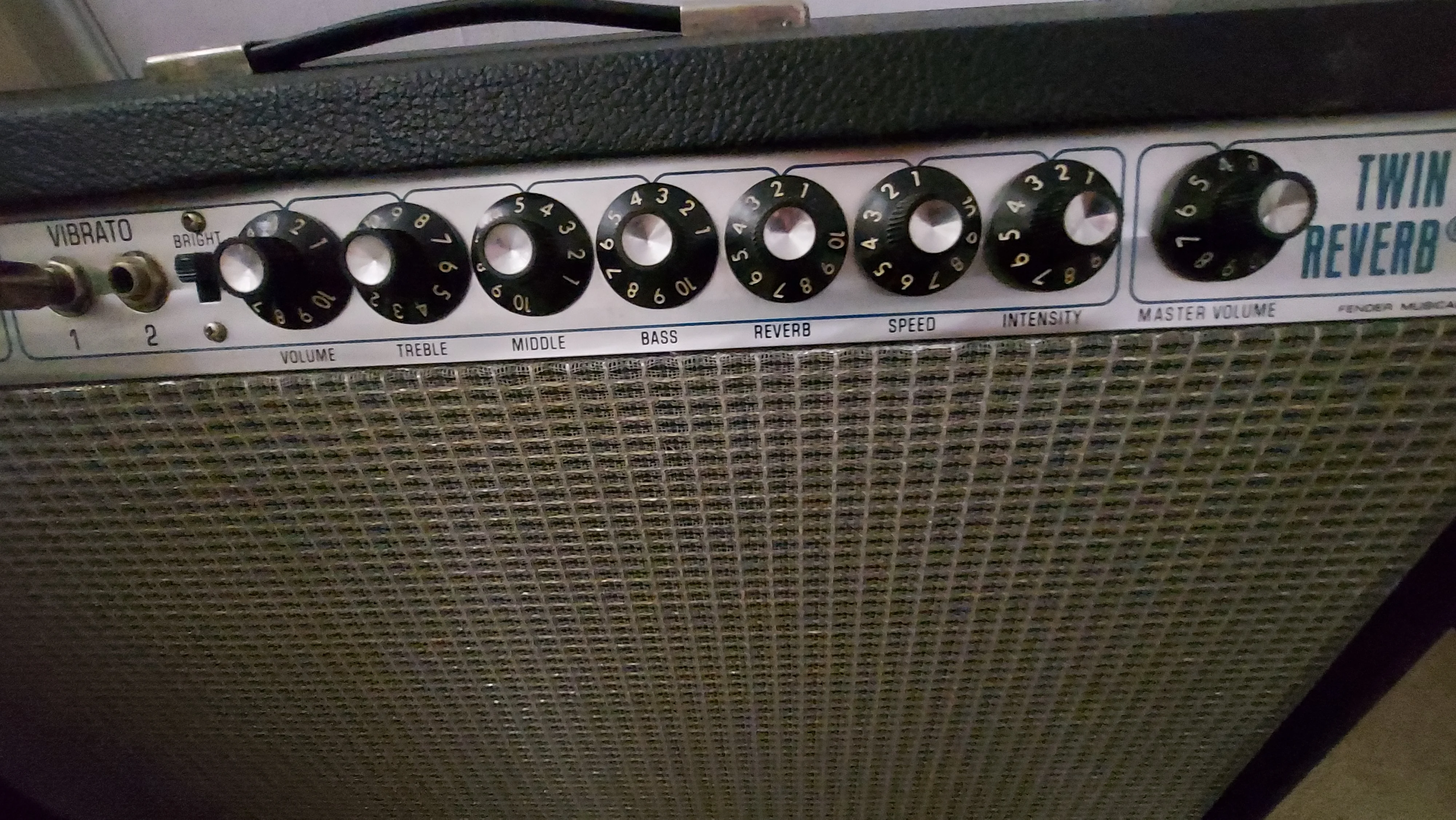

So my pedal is DS1 and my amp is fender ultimate chorus. I have a twin reverb but I wanted to try the fender ultimate chorus for recording mic because my twin is stock with and I personally like the sound of the celestion speakers. I wanted to do more recording last night but my instrument cables are giving me trouble all of a sudden
I uploaded the results from the Ultimate Chorus here.
-Celestion Speaker 75
-Shure XLR Cables
-SM57
-Uploaded pictures of speaker positions.
I also used my stock 1980 Twin Reverb for just one recording and uploaded the results.
-Stock Speakers
- Shure XLR Cables
-SM57
Everything was recorded with the scarlet solo.
