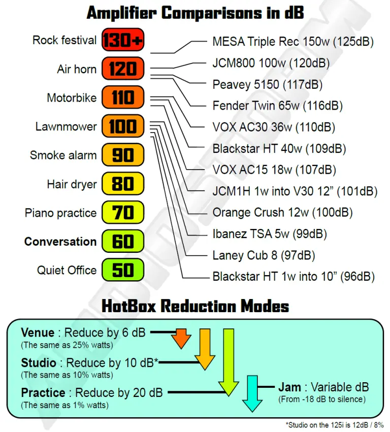

Is a Sm57 meant to be placed infront 1-200watt amp?
people sing around 100-110db
every 3db = x10 louder

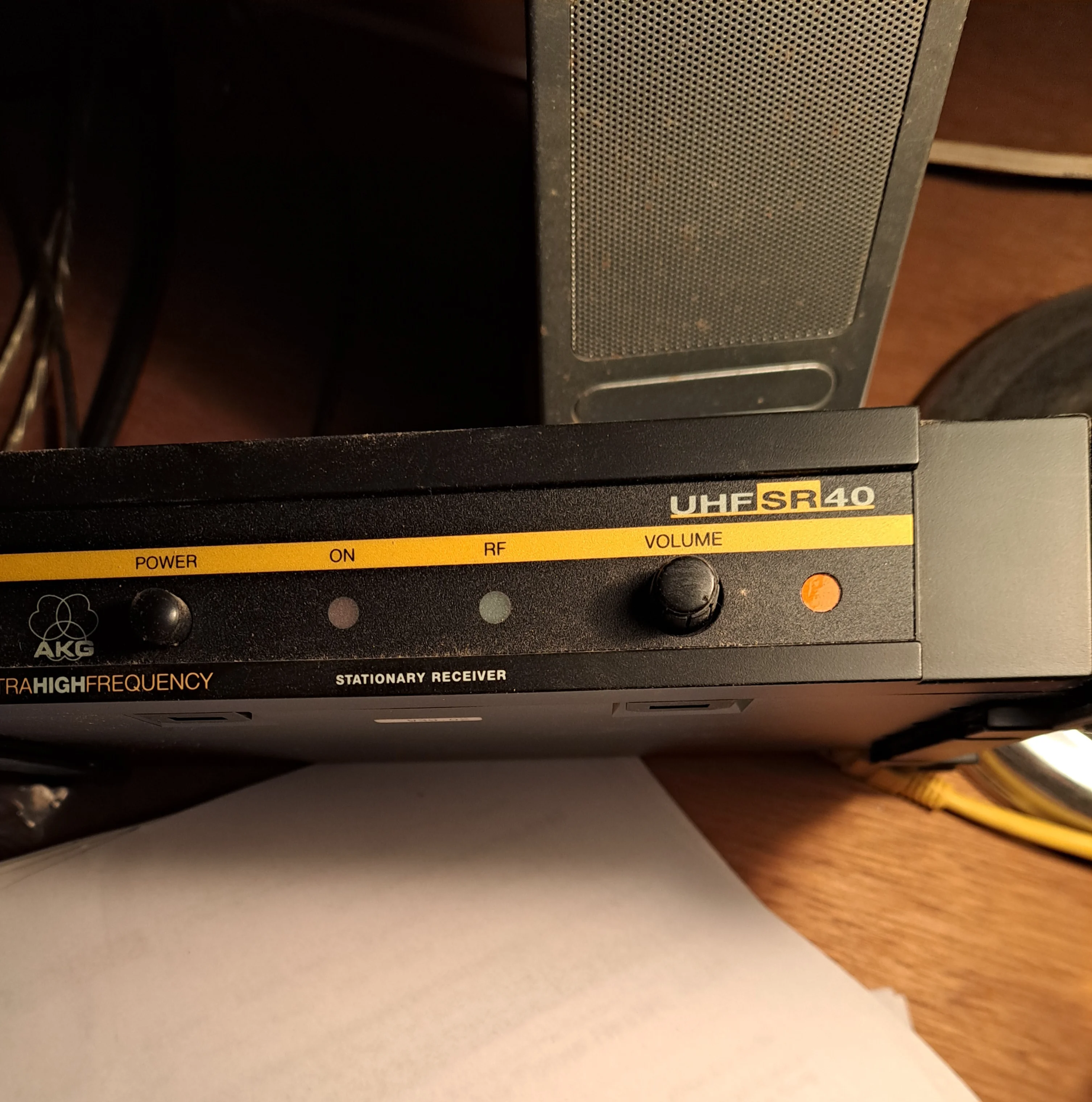

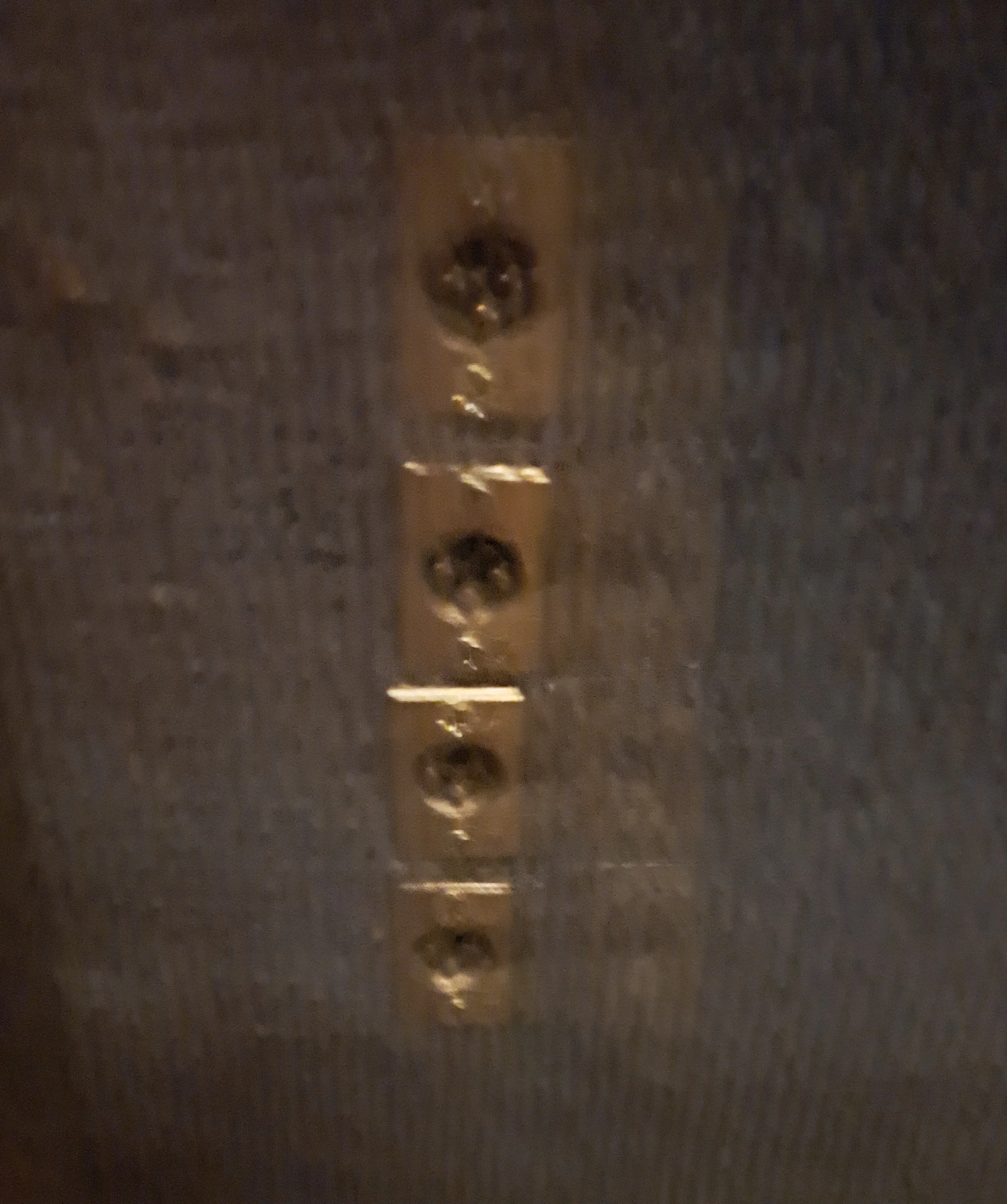

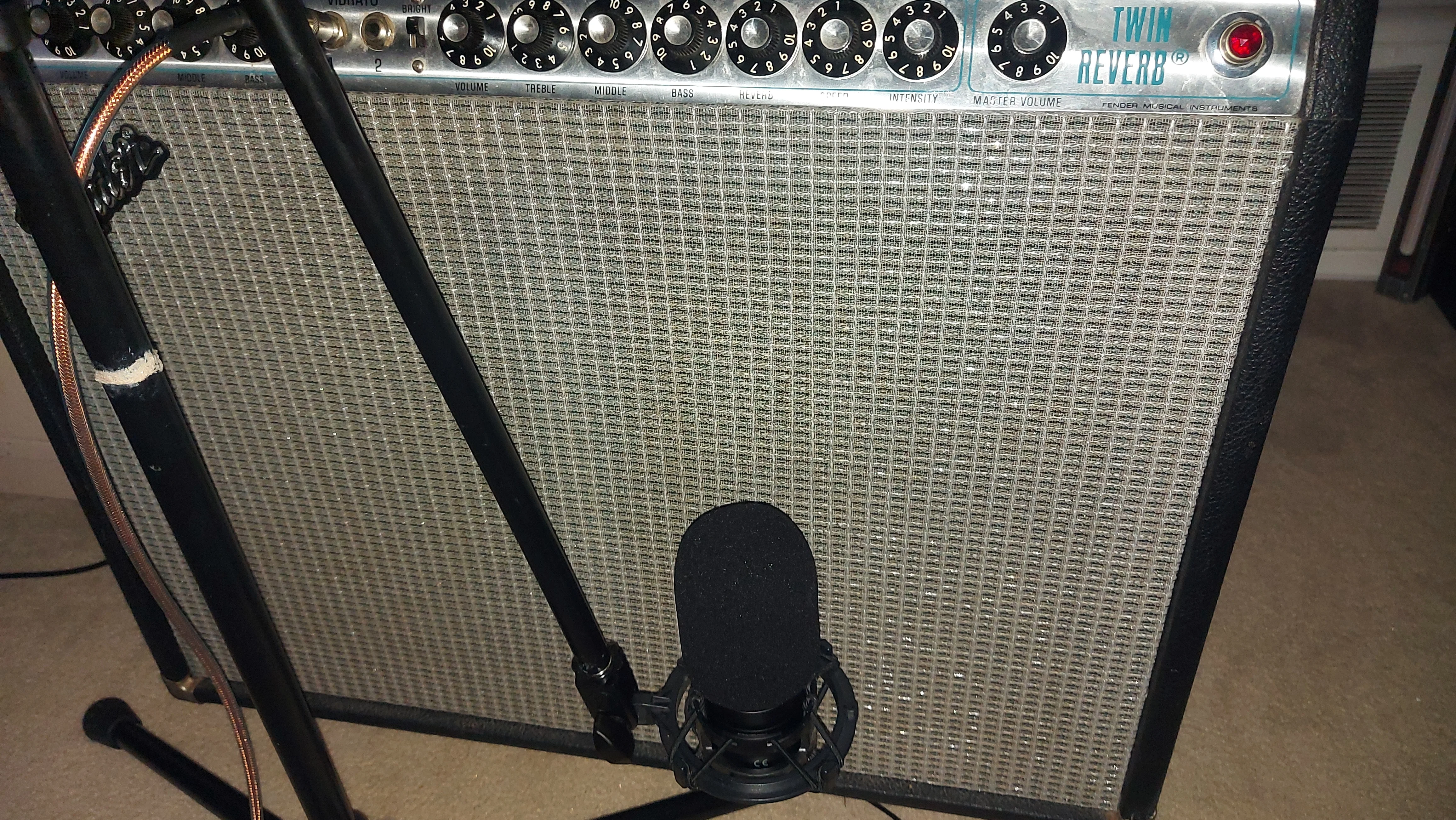

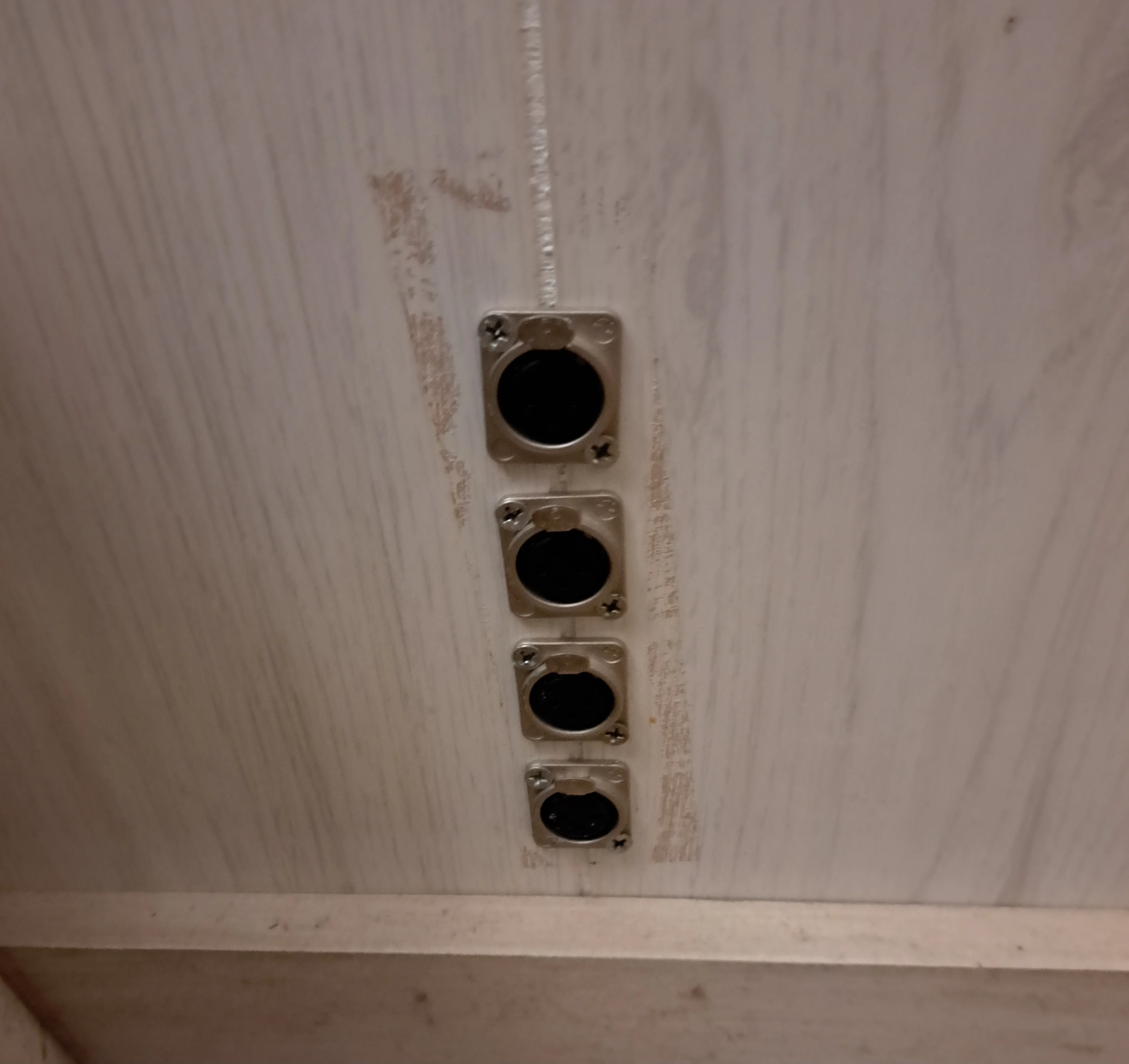

For what's worth, IMO, it's possible to record HUGE tones from amplifiers whether or not they are rated at 5 watt or at 100 watt.
My recording room is 12' x 24', fully treated with absorbers and bass traps. The largest problem I encountered was the loudness of my amps whenever I recorded because it annoyed the lady of the house whenever I cranked it
I constructed a small 6' x 6' double insulated walled room within a room to house my amps. 90% dB reduction.

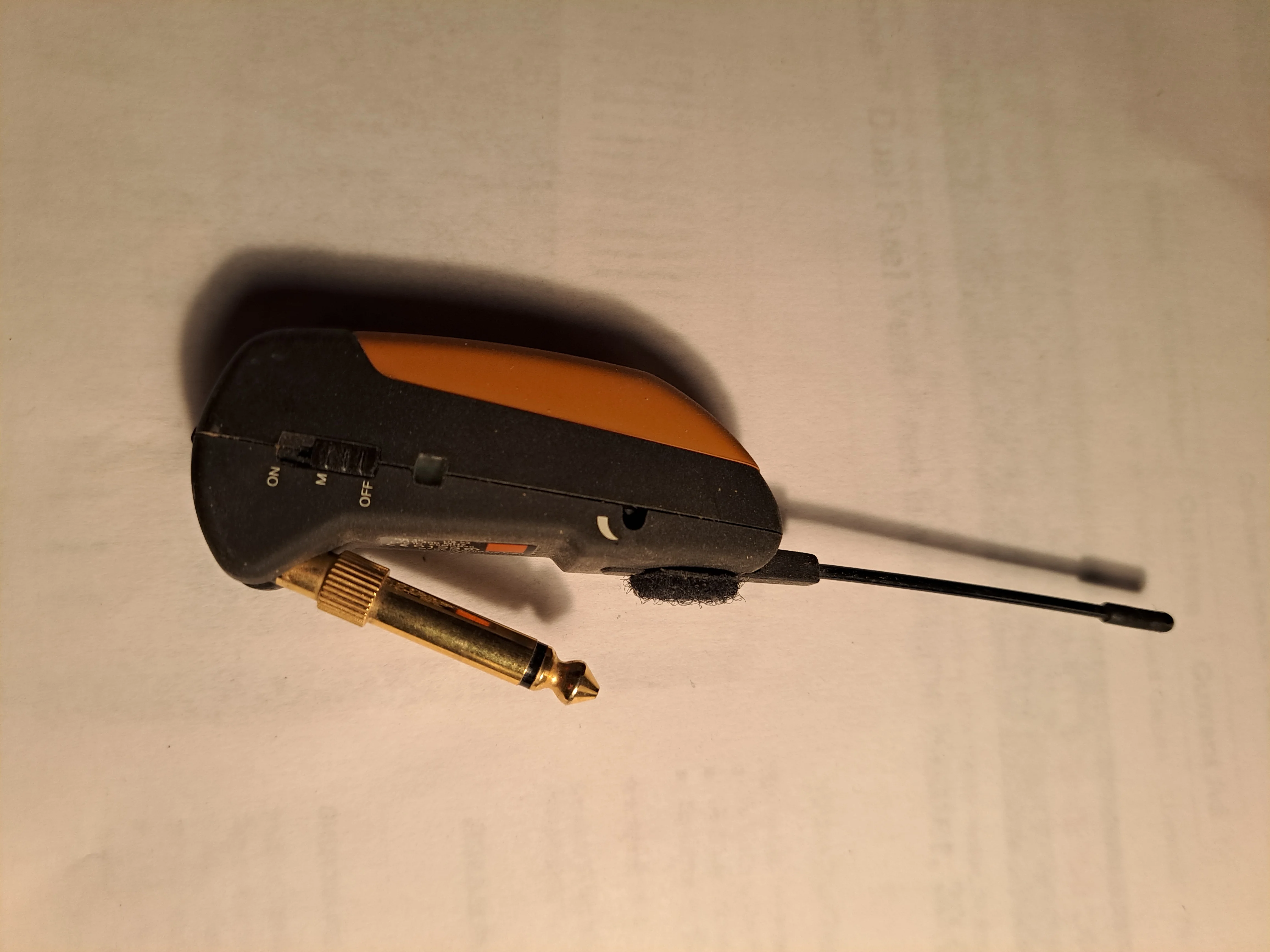

I wired up and installed XLR connections between the the small room and larger room to connect with my recorder. I also use a wireless AKG WMS between my guitar and amp freeing me up to monitor the recorder.

Quite a interesting setup! Looks like you got a good home recording studio.

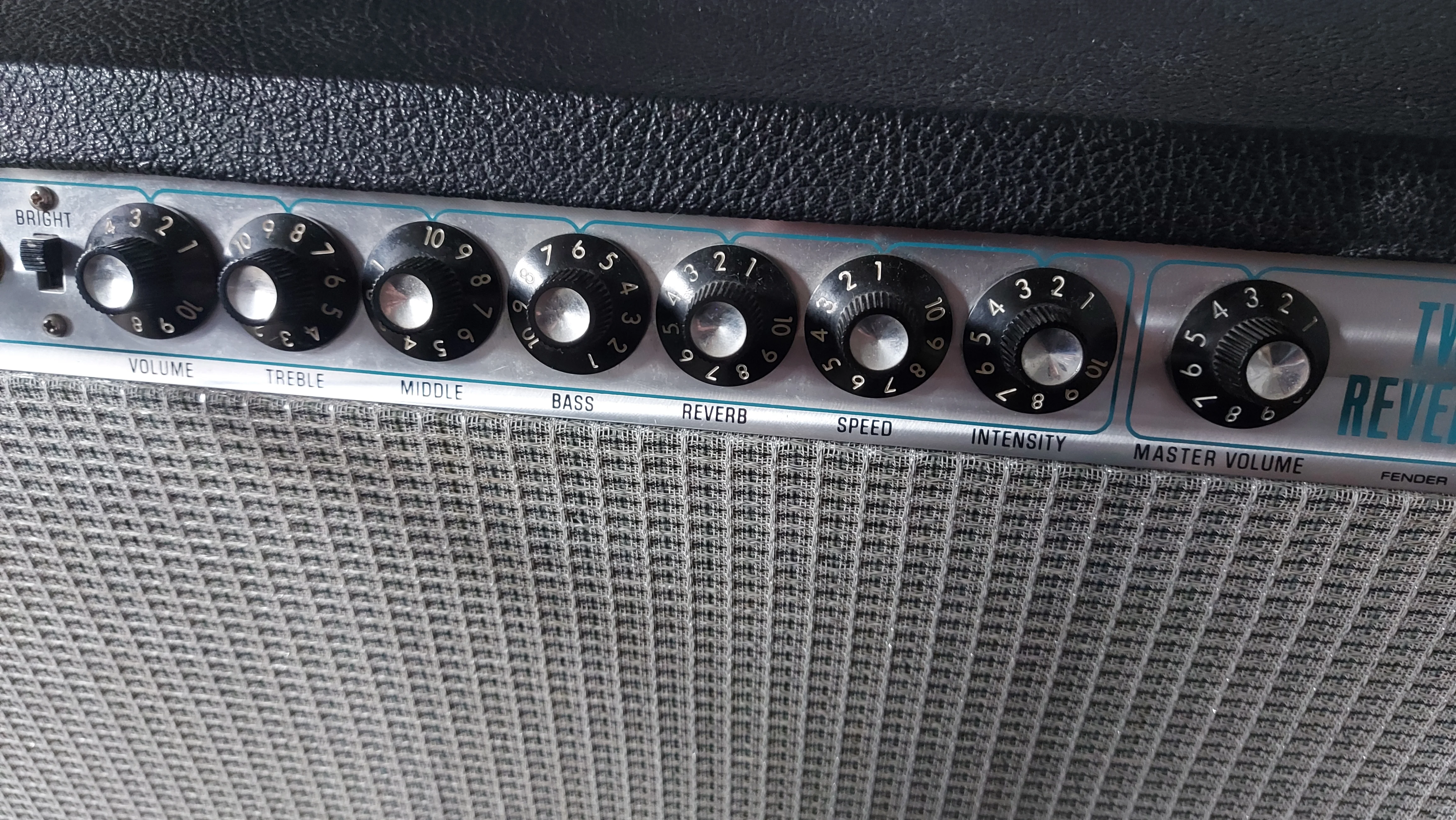

I will interject here and point a couple of the problems as I see it. First your guitar is out of tune - second you have to woodshed/practice a lot more (if you can) -
those two items will improve your sound quite a bit - as for the recorded sound - it sounds to me like you aren’t positioning the microphone correctly and don’t have the amp loud enough - a Twin Reverb is meant to be played with a volume of around 3 - 4 - you might get it okay on 2 but it will be exponentially harder - there is going to be sweet spot where the sound is right and the tone comes into focus - the way you could find it is by putting on headphones and playing - moving the Microphone around - and I mean by 1/4 inches from the center out - and trying it on both speakers to see which one sounds better - it’s pretty obvious when you get the tone spot for the sound you want.

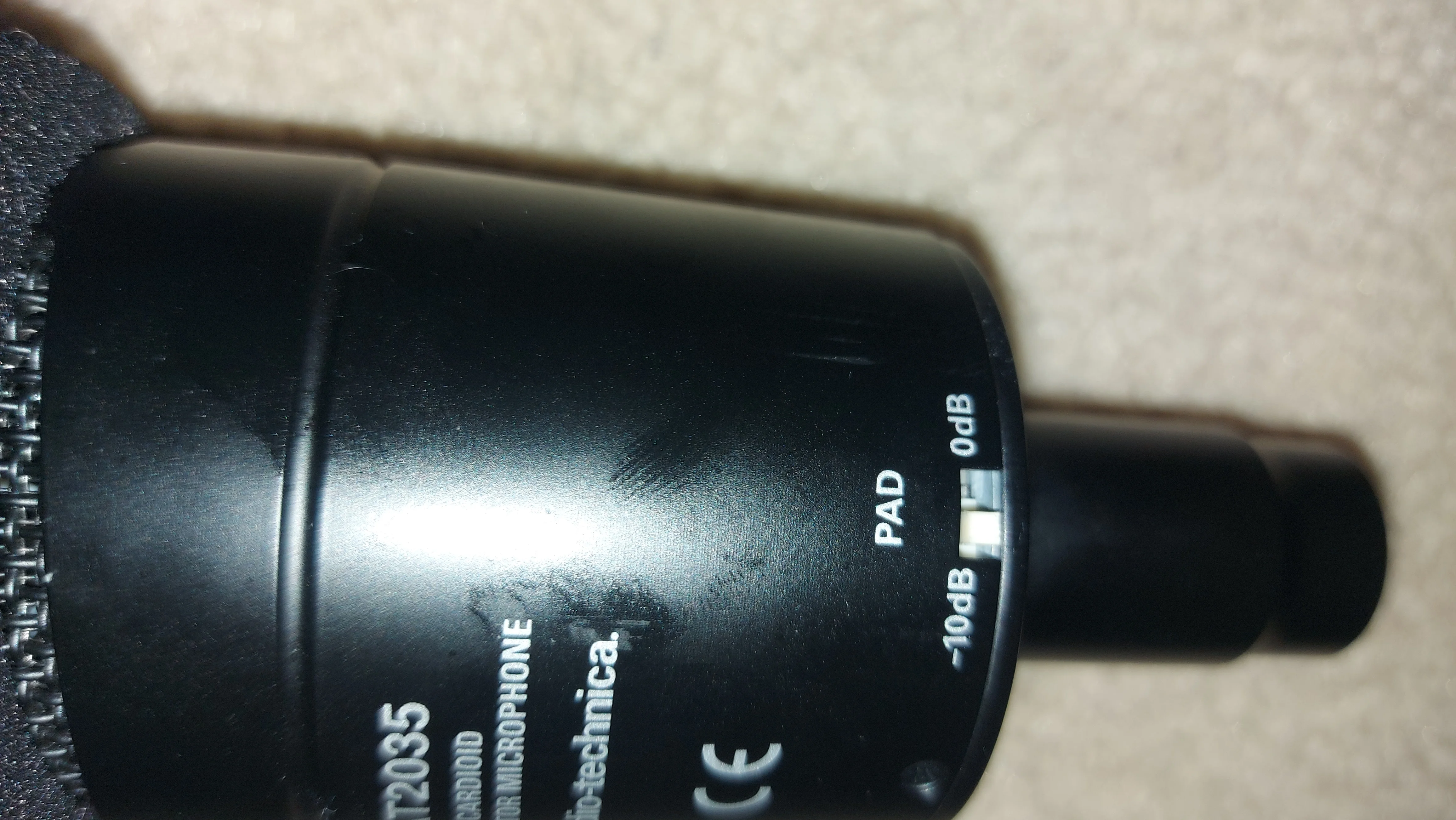

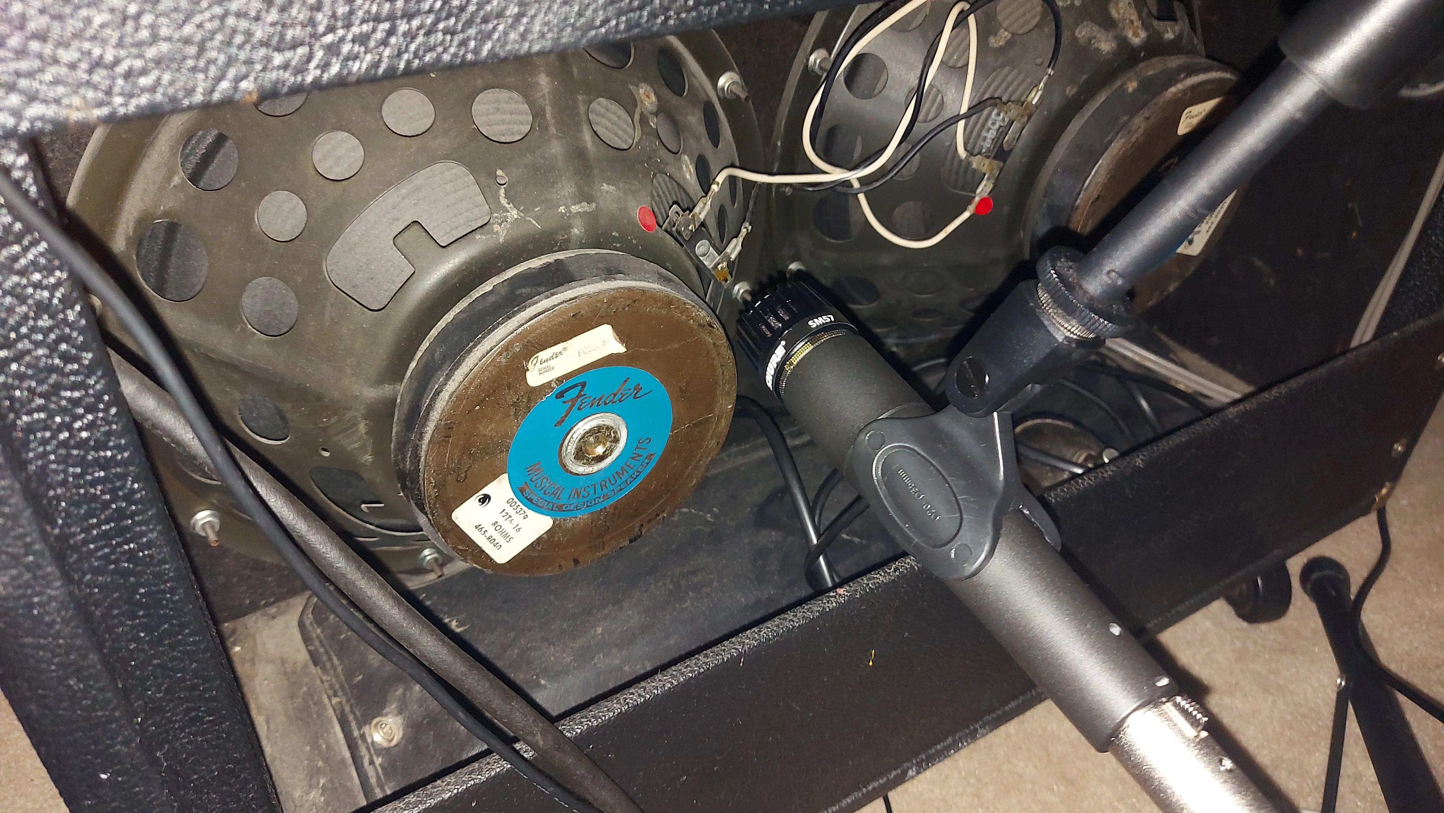

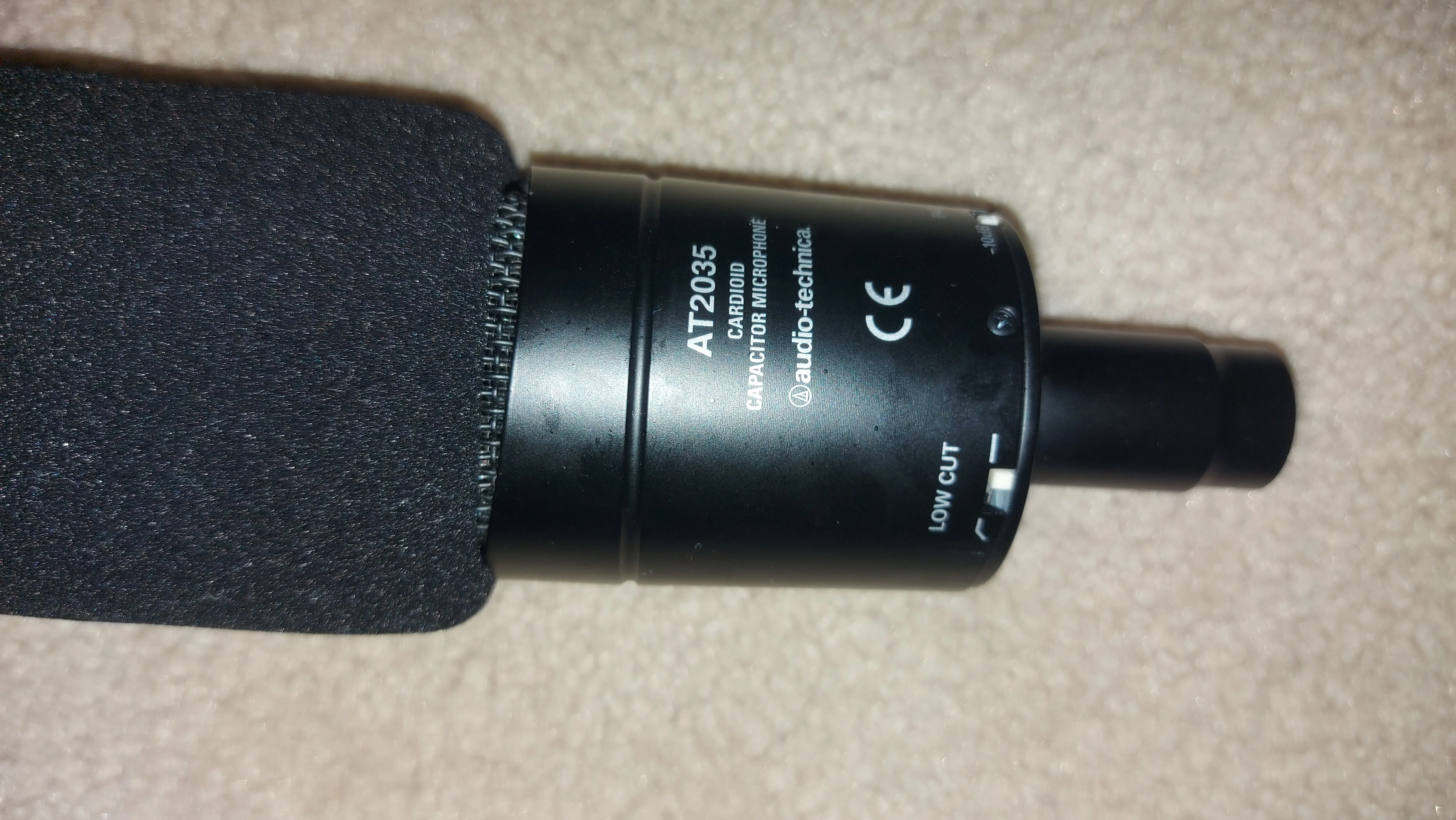

Ok excellent thanks for your help! Im looking for a live stage sound if that makes sense rather then a studio sound. So i heard micing the back could help you get this. The at2020 also has a lowcut mode and a pad mode.
You hear and read a lot of things on the internet... It doesn't mean much. I can't remember anyone I know micing the back of the speaker.
As for the lowcut switch, you really don't need to use that. Your recording lack the balls that a good guitar track has. That comes from the lows. Especially with the DS1 engaged, you're all sizzle.
